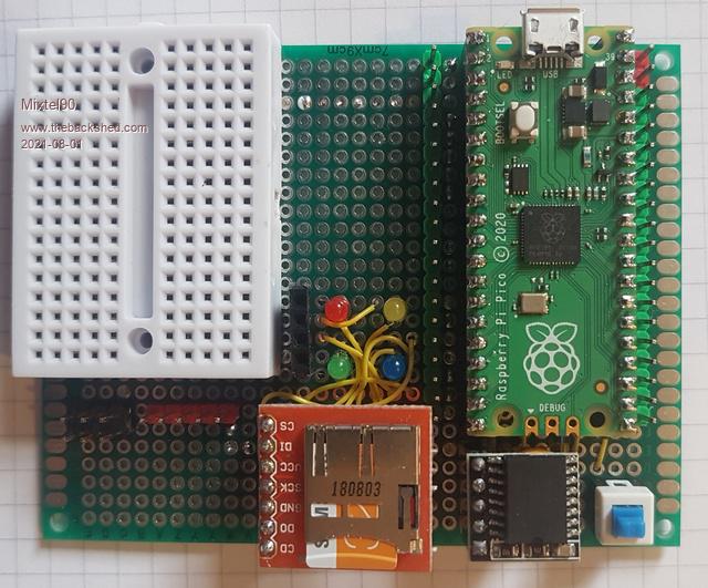

I've been getting fed up with carrying a breadboard & PicoMite around with me when developing the PIO assembler. I do most of the work on the days that I go to look after my mum, so the breadboard, laptop, charger, books etc all take up half a sofa. :)
Anyway, I decided that it was time I had a development system. But which one? I don't really need Grove ports and LEDs on everything, but a few would be useful. I don't really need a display. A power switch would be useful so that things could be plugged and unplugged without disconnecting the USB. SD card is essential. RTC would be nice, as would a reset button. It would be better if it was as cheap as possible too. :)
This is what I came up with, built mostly from what I already had around. The SD card module was a special buy. The RTC was bought for my PicoMite backpack (when the PCBs turn up). There is a 90 degree reset button underneath the RTC module. The blue buton pulls 3V3EN down to switch the 3.3V supply off. The little breadboard has the "bumps" at top and left so that it can be expanded if necessary. I can just about fit 3 buttons in the bottom left corner. If/when I get a Round Tuit.
