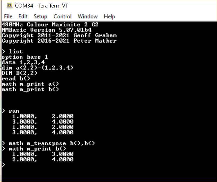

Since some features are still in beta, would it be possible to bring CMM2 in line with other BASICs that have a MAT READ and vary the column faster than the row? I don't think that many programs have been written yet that this change would break while there have been thousands of programs that need rewriting as it is now.
In other BASICs:
DIM A(2,2)
MAT READ A
DATA 1,2,3,4
MAT PRINT A
1     2
3     4
In CMM2 BASIC
DIM A(2,2)
READ A()
DATA 1,2,3,4
MATH M_PRINT A()
1    3
2    4

Posts: 12084
Posted: 02:44pm 31 Jul 2021
As I've explained in all matrix operations in MMBasic the fastest moving dimension is the first.  Everything is self consistent. For your program just reverse the indices in your for loops. This isn't going to change.
From the manual
  Quote  Note:
2 dimensional maths matrices are always specified DIM matrix(n_columns,
n_rows) and of course the dimensions respect OPTION BASE.
Edited 2021-08-01 01:38 by matherp
