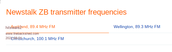

hitsware2
Joined: 03/08/2019
Posts: 738
Posted: 03:29pm 30 Jul 2021
try this
this
or this
Edited 2021-07-31 01:33 by hitsware2

@ hitsware2: Thanks for the links, but none of those support the station I want.  Thanks for posting those links though.

@ hitsware: Newstalk ZB is only available on AM in my area(with the crappy sound quality), not on any FM frequency.  This is why I am trying to transmit locally on an FM frequency.
