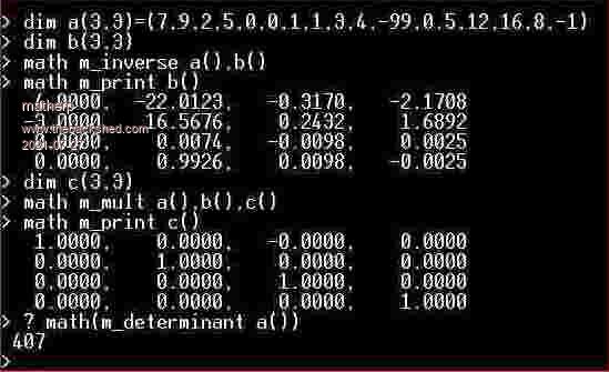

MATH INVERSE array!(), inversearray!()
This returns the inverse of array!() in inversearray!(). The array must be square and you will get an error if the array cannot be inverted (determinant=0)
New math function
MATH(DETERMINANT array!())
returns the determinant of the array. The array must be square

New math command
New math function

dim a(3,3)=(7,9,2,5,0,0,1,1,3,4,-99,0.5,12,16,8,-1)
dim b(3,3)
math m_inverse a(),b()
math m_print b()
dim c(3,3)
math m_mult a(),b(),c()
math m_print c()
? math(m_determinant a())
