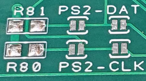

The directions say to connect all four contacts to use a PS/2 mouse with Gen 2. So one big blob of solder that touched all four contacts would work? Or did it mean to connect the contacts in two pairs?

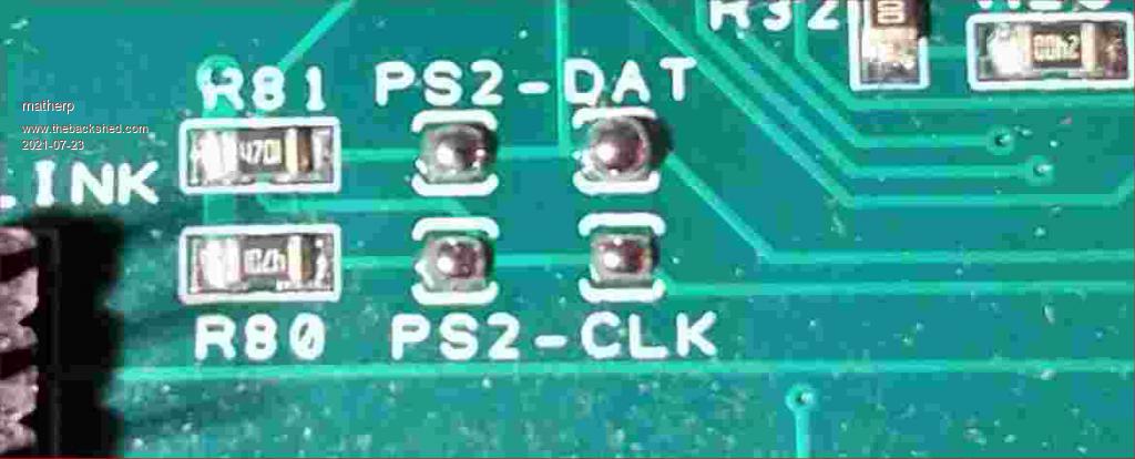

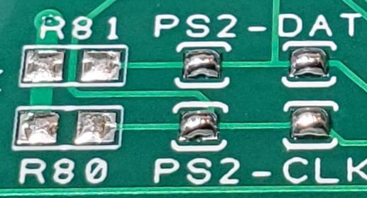

Assuming you are talking about a standard G2 then there are 4 shorting links on the G2 board. Each of them needs a blob of solder. Two of the links connect the PS2 clock and data  lines to the requisite pins on the G2 and the other 2 apply pullups to 5V on those lines.

Posted: 08:09pm 22 Jul 2021

Posted: 09:12pm 22 Jul 2021
Note: R80 and R81 must be populated with 4K7 resistors (472 or 4701)

Posted: 10:20pm 22 Jul 2021
It should be noted that it is either or, not both Hobbytronics and PS2 configured at the same time.
If you decide to fit a Hobytronics IC to use USB mice, it will be very difficult to go back to PS/2 mice. It would require removing the Hobbytronics chip.
There are a couple of jumpers to solder for the PS2 so easy enough to undo if required.
PS/2 mice only need a passive adapter to fit the USB socket so much simpler (and cheaper) The Microsoft Classic and most USB/PS2 mice don't even need that, just plug them in.
