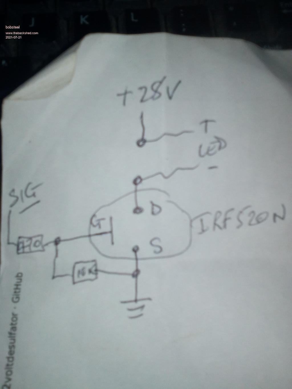

I have an arduino 5 v signal coming into a N channel Mosfet
Using a IRF520 Mosfet C=783pF , Vt=3.6 v , I have its Gate driven by a 5 volt output signal from the Arduino through a voltage divider of 470 Ohms signal side and 10 K on the 28 volt negative .Common ground wire. Atm The light stays permanently on when full voltage is applied to the Light anodes on the positive with Mosfet under and source connected to ground.
Reducing the 28 volt supply down to about 8-9 volts brings the signal through and flashes the lights but it is no good to me down there and I'm driving 2 lights atm both flash on each signal instead of them flashing individually.
Can anyone tell me why it would be doing that ? Is it bleeding current through the internal diode perhaps. I don't understand that.
So I am trying to drive 3 separate LED lights ,current limited , with 3 of 5 v  signals coming off 3 pins of the arduino.
Can this be done?

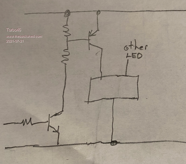

I had a brief look at your other post and it appears that you have two common cathode LEDs so you will need two high side drivers to drive each anode circuit separately and connect the cathodes to zero volts. It may need a couple of transistors or FETs to level shift the drive signal for each high side driver. I don't know what is limiting the current for the LEDs internally but it's probably not a simple resistor so there may be leakage in there that is causing the other LED to come on.
I'm suspecting that gate voltage is not high enough to turn the FET off at 28 volts until you lower the supply voltage.
Transistor circuit
You may need this sort of circuit to drive the FET if you want to use it.

A bit of checking suggests that you can't use an N channel MOSFET as a high side switch because you need a gate voltage higher than the drain voltage to turn in on. The drain voltage will be 28 volts when it is off. Unless you have a way of providing a higher voltage than the 28 volts that is.

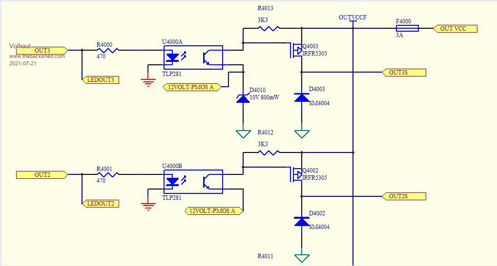

Common cathode LED lamps can be driver directly from PLC outputs. The typical 24V PLC output has a P-FET or PNP transistor pulling the output to it's 24V line.
These circuits are directly usable at 28.8V also (PLC's often have a spec up to 30Vdc).
IN essence Turgo46's circuit will work. For 450mA (white LED) you will need roughly 2.2k resistors in all 3 locations. The input transistor can be a BC548 or similar, the output transistor a BD140 or beefier.
Example of a PLC output circuit (using optocouplers to isolate the power circuit from the digital circuit.

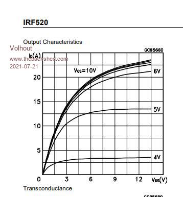

The IRF520 is a nice FET, but it needs a nice gate drive voltage.
This shows the FET will not turn on fully when the gate voltage is 4V or lower. It needs minimal 5V, but preferably 6V or more.
So you can not drive it with 3.3V from a mite. You need special "logic voltage" FET's, or a driver transistor and higher voltage.

Volhout's component suggestions might be OK but the BD140 is a darlington transistor and the Vce saturation voltage is therefore higher than I would like at 2 volts. It is also an NPN and not PNP. I would use something like a TIP30 and drive it harder.
I still believe that the circuit I presented is the simplest required to do the job.

I must be missing something. Why all the talk of hi-side switching?
In his photo, the load is north of the mosfet with a grounded source. That is low-side. N-MOSFETs are an ideal solution here, done it myself many times.
what have I missed?

Posted: 05:28pm 21 Jul 2021
it's a 3-wire led spotlight, apparently, in white and blue, with a common cathode. It includes current limiting and the working voltage is specified as 24v IIRC.
PMOS high side switching would be ideal but he hasn't got them. I'm afraid that any messing about with the IRF520 is probably a waste of time and effort. Money spent on bits to get them to work would probably be far better spent on some new P-channel FETS or relays.
Posted: 09:29pm 21 Jul 2021
ah right - I went purely from the circuit in the photo.
no, in that case his circuit as drawn won't work. Needs an artificial high voltage for the gate or a bootstrap  like this

Posted: 10:10pm 21 Jul 2021
Trying to make sense of this?
28 volts in on vcc I guess and green triangles are ground but the optos have a different ground.
Input micro signals in on the left.
What the heck is all the rest?
Where can I learn what all that means ?
There is a 12 volt input and a zener on one gate but not the other.
seven outs ,an R4013 and R4012 but no R4011?
F4000 Im guessing is a fuse?
Quite confusing at first sight sorry.
Is this perhaps dealing with electrons coming in on the negative and out on the positive?
Edited 2021-07-22 08:17 by bob.steel
