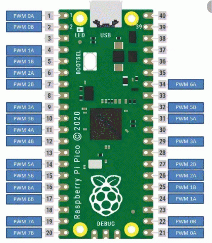

By the way, does this accurately display what's available in the way of PWM?
Edited 2021-07-17 10:15 by lizby
Posts: 9273
Posted: 06:16am 17 Jul 2021
That agrees with the Micropython book, so I assume it does. :)
