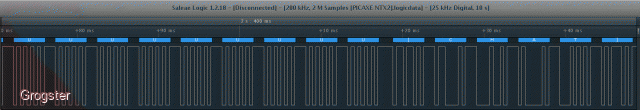

PICAXE output:

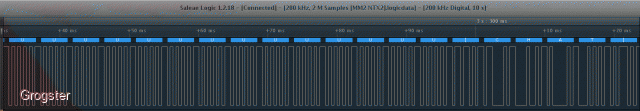

MM2 output: (this is with the S2 option on the COM port)

There IS a distinct gap in the PICAXE data stream that is not there in the MM2 data stream.  Seems there is about 1.4ms delay between each and every byte on the PICAXE, which is not the case with the MM2 output.  This will simply be the PICAXE interpreter delay I think.
Perhaps I could re-write the MM2 output so that it takes the string, and outputs it one byte at a time, followed by a 1ms pause or something.  I might experiment along those lines.

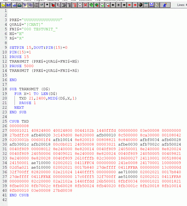

Borrowing from Justplayin's suggestion, I used the bit-banged serial Cfunction, and output the bytes one at a time.  I don't even need a delay in that situation, as the natural FOR/NEXT interpreter delay introduces just enough of a pause between bytes, that the PICAXE decodes the message perfectly.
My new testing code that is working:
