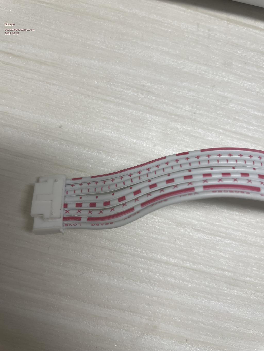

I mean it contains the link on the hardware and the communication after connection, it sent a flat 8pin cable, I don't know how should I connect it with Arduino or other microcontrollers.

I think you'll have to get the data sheet for that particular model of display. I don't think there is a standard as such and it's guesswork otherwise. It's not just a case of physically connecting it either, you'll have to figure out how the signals work.

For the hardware side of it, the datasheet shows which pins on the cable are for power (Vcc 3.3V and Ground) and TTL serial transmit and receive (Tx & Rx). Tx on the display goes to to Rx on your MCU and Rx on the display to Tx on the MCU. If the MCU uses 5V signals (eg Arduino) you may need a voltage divider to reduce its Tx to 3.3V.
1.8k in series with 3.3k should work.
This isn't just an LCD touch screen, it has it's own MCU and memory into which programs can be loaded. There is a lot to learn. Search their website for instruction manuals and sample programs for it.

Yes, you explained it in great detail, I think I understand how to connect it, maybe I need to strip the wires I need to use and then solder them on the Dupont wire and plug them into the Arduino board.
