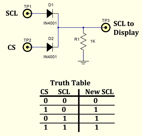

Posts: 2983
Posted: 06:01am 02 Jul 2021
Hi Mick, All,
I had a little think about this,
I think this might work for you (haven't tested it)
Use a couple of schottky diodes and a pull down resistor.
You may have to fiddle with the pull down value a bit but it logically looks ok to my feeble brain.
You wont get an SCL signal to your display unless BOTH the SCL is low and the CS is low
The other Mick

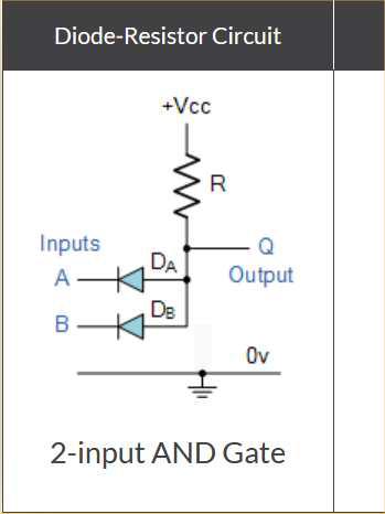

Posts: 12084
Posted: 07:23am 02 Jul 2021
The normal discrete and gate has a pullup on the output and the diodes the opposite way round.

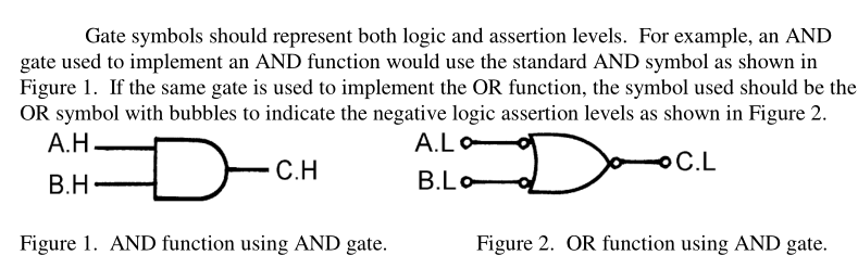

Posts: 2983
Posted: 04:42am 03 Jul 2021
Hi All,
As Promised earlier.
Here is a snippet from >>> This PDF <<< on Negative Vs Positive logic (Page 3 of 8)
This is showing the Reverse of mine as an AND in positive logic and how it should look in as an OR in negative logic. Note the shape changes and the inputs/outputs all toggle the bubbles.

Posts: 9273
Posted: 07:40am 03 Jul 2021
It looks fair enough, Mick. I'd try it now but I took the display off the board and put it away - and it's the same Pico that I'm using for the PIO assembler so the less flakey bits on there the better really. :)  Schottky diodes would be good to get a better defined low. Pull-up resistor shouldn't be too bad, but too high and it slows the gate down.

I tried your circuit, Mick. Partial success. At least the screen lights, but gui test, text and cls(colour) do nothing. 10k was too high to work, 1k gave these results. I went for 1n4148 diodes as they were handy - and are probably more suited to this job anyway.
Not sure what they did on the module, but on the chip CS is active low and data seems to be read on the rising edge of SCL. It might be a timing issue, I suppose.

Posts: 2983
Posted: 01:32am 04 Jul 2021
Hi MICK, All,
If it was me I would do the modification as Disco4now suggested, it looks fairly easy.
Can you provide more detail on this model display as I wouldn't mind experimenting with one?
Re my circuit, sorry it didn't work as expected, I was worried about timing hence why I selected Schottky diodes.. plus they should give a higher HI as they only drop .2-.3v compared to your IN914 of .6-.7v which would drop the high to say 2.6v you should get about 3v using schottky.
It is a tricky one, I wonder why they didnt bring the CS out to at least solder jumper option pads.
You could try dropping the resistor to 470R or even trying a 100nf in parallel to the resistor to slightly extend/delay the SCL to the display.. it may or may not work..
A gate might be a much better option, besides the mod, look for a chip that can run off 3v3 and is reasonably fast..

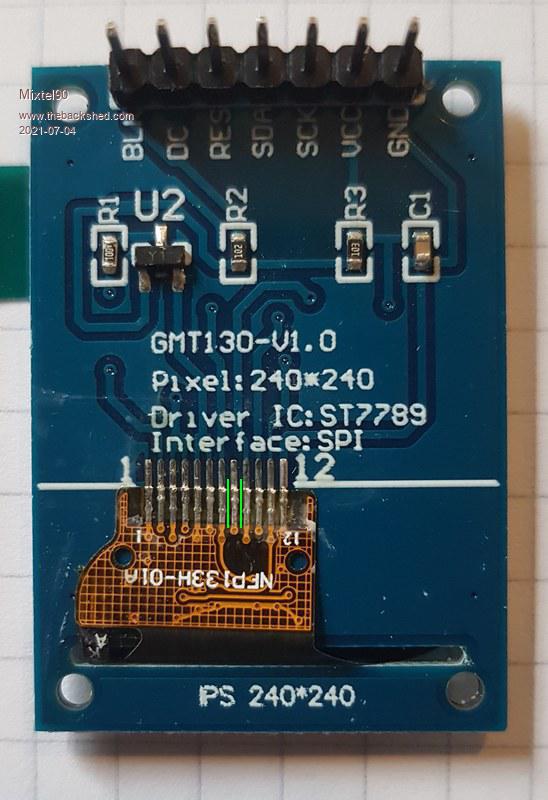

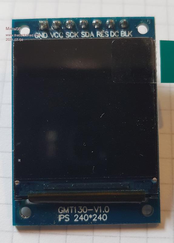

Posts: 9273
Posted: 12:37pm 04 Jul 2021
I'm doubtful if I could do the mod to the display now, Mick. My efforts with fine soldering haven't been very successful recently. It would have been *nice* to put it on the PicoMite, but it's by no means essential and these displays aren't expensive.
This is the display I ordered.
Having finally had a proper look at the back it's not quite the same:
https://www.ebay.co.uk/itm/393093456134?ssPageName=STRK%3AMEBIDX%3AIT&_trksid=p2060353.m2749.l2649
Although connections are the same, the pcb on the one I received isn't laid out the same as either the one used for the mod or the picture on ebay! All the ebay pics for the 1.3" model seem to show the same version, but goodness knows what you'll actually get if you order one.
Edited 2021-07-04 22:47 by Mixtel90
