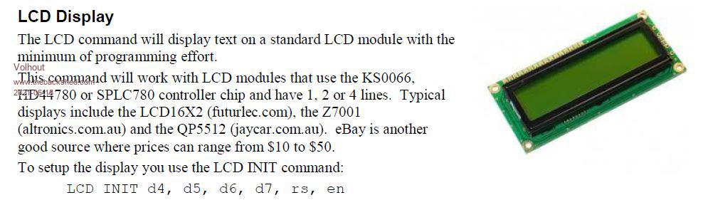

Another option could be is to write the text to a 1602 LCD. That could work independent of the SSD1963 since the commands are completely different, as is the hardware interface.

With the LCD display you also have the option of using the i2c version and only using 2 pins. The driver can quite happily live in the library on a Micromite and, although it doesn't share the same commands as a graphics display, is straightforward to use. If you can't find a i2c version then there are very cheap adapter pcbs on ebay.
