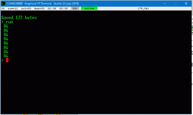

Posts: 10076
Posted: 07:09am 24 Jul 2021
Further to this, I am getting a result, but it is ALWAYS the same number no matter what.  I have tried all the SPI modes, and although I get different values for different modes, the values for any given mode is always the same number.
I pick up the thermocouple in my hand, which should change the reading as my hand warms up the thermocouple, but that is not happening.
Anyone got any ideas of anything else I can try?

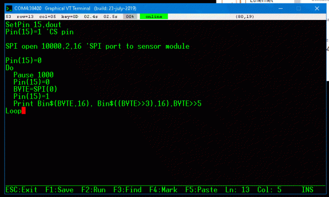

Posts: 3420
Posted: 07:53am 24 Jul 2021
As an experiment to see what the thermocouple is doing, print the whole 16 bits in binary then warm it and see which bits change.
Pause 1000
BYTE = SPI(0)
Print BIN$(BYTE, 16), BIN$((BYTE >> 3),16)
loop
The data sheet says bit 15 is always 0 so:
D = BYTE >> 3
As shown in a pervious post should do the trick.
Also try swapping D+ and D- to see if the thermocouple polarity is wrong.
Edited 2021-07-24 18:26 by phil99
Posts: 6209
Posted: 05:55pm 24 Jul 2021
Hi Gogster,
If you get consistent &h84 out of the MAX6675 it is possible (I don't have one to prove it) that the T- terminal is not connected to ground. Of coarse it should be connected to the thermocouple, but also to GND. Bit 2 (the "4" in &h84) signals a open thermocouple when T- is not connected to ground.

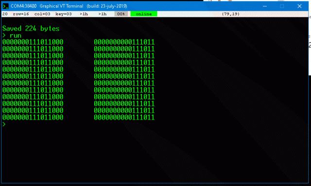

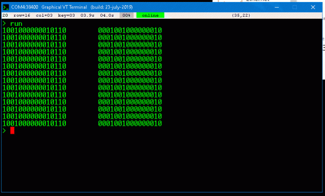

Posts: 10076
Posted: 04:16am 25 Jul 2021
Hi chums.
This is the result of phil99's code changes:
Does not matter if I touch the thermocouple or not, result is always the same.
This is the result of disco4now/Geoff's code:
I tried slowing down to 10kHz SPI speed, and the data is ALWAYS still the same, no matter what.  I will hunt out another thermocouple and try again.
EDIT: Removed thermocouple unit completely, and still get the same results.  Something not right here.  Either the thermocouple is crook, or the chip is or something.
EDIT: Put a brand new(different) thermocouple on it, still exactly the same output.  I wonder if the module is a fake.  I think I will order a few genuine chips in my next element14 order, and swap one of the chips.  SOIC8, so easy enough to remove.  I can already hear WhiteWizzard scolding me for this.....
Edited 2021-07-25 14:55 by Grogster
Posted: 04:50am 25 Jul 2021
The results form Phil's code looks like 14.75 degrees.
Could that be your current ambient?
If so, it might indicate that you have t+ and t- shorted.
Try that code again with the thermocouple removed but t- still connected to ground.
That should light up bit D2
Just saw your edit - you must be a mind reader.
Look for a short between the two input pins.
Edited 2021-07-25 14:51 by TassyJim

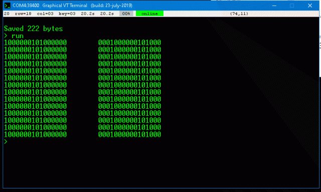

Posts: 10076
Posted: 05:03am 25 Jul 2021
Hi Jim.
No, ambient is 22'C or so.
Result of disconnecting T+, but leaving T- connected: (T- is grounded)
Edited 2021-07-25 15:05 by Grogster
Posted: 05:12am 25 Jul 2021
OK,
Bit 2 has correctly gone high to indicate open circuit thermocouple.
Next try shorting T+ and T-

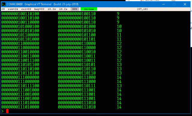

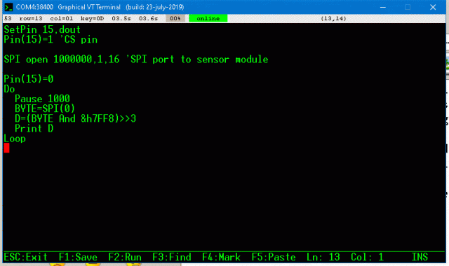

Posts: 10076
Posted: 05:18am 25 Jul 2021
FOUND THE PROBLEM!!!!
I was NOT releasing the CS pin at the end of each reading, so I guess the chip was doing ONE sample, and then cos I never released the CS pin, it just kept sending the same data each time through the loop.
Results I am getting now: (third column is degrees C)
...and the code I am now using:
Now that I have it working, I can now experiment some more.
Results are coming in now for both the original thermo, and the new one I tried.

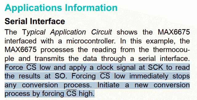

Posted: 05:25am 25 Jul 2021
That's good news.
Something to store in the memory bank for later use...
I went looking through the data sheet again:
  Quote  Force CS low and apply a clock signal at SCK to read
the results at SO. Forcing CS low immediately stops
any conversion process. Initiate a new conversion
process by forcing CS high.
Edited 2021-07-25 15:29 by TassyJim
