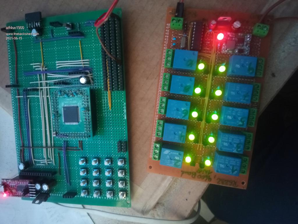

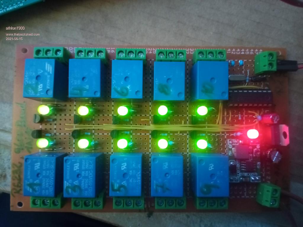

Hello @all !
First i'm only a hobbyist in electronis.
But i'll share my relais project.
The story :
There are many relay cards to buy, but they all have one disadvantage.
They are using too many pins. 1 pin per relay.
Sure, there are I2C / SPI gpio extenders such as MCP23017, the control for beginners is a bit difficult.
That's why I made a relay card with control via RS232.
it is very easy to control, just send a string to the card to switch the relays.
Fast, uncomplicated, only 1 pin!
Since RS232 is used, an ESP8266 or ESP32 can also be used for control.
It's easy with the esp-link firmware.
I realized it with a Pic18F84A, which I still had lying around.
If someone is interested, I can upload the hex file.

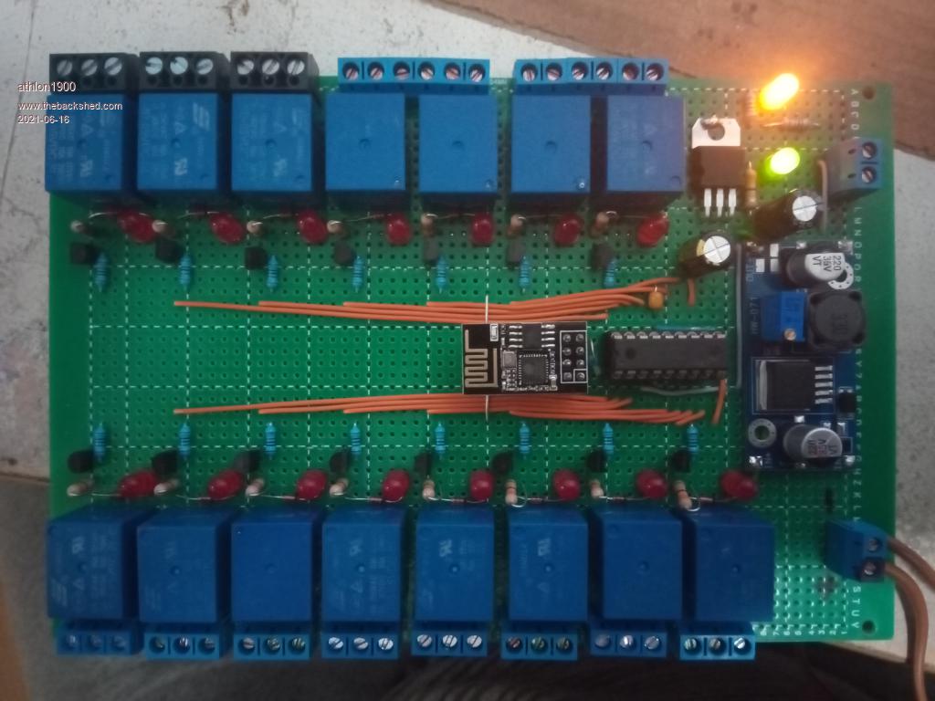

I also built a 15 channel board with an optional ESP01 slot for a friend.
This is based on a Pic16F819.
(see image)

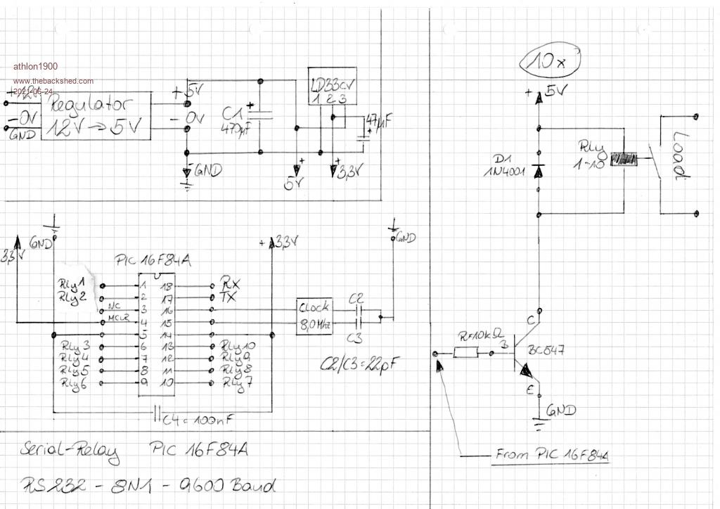

For the sake of completeness
Here are my (dirty   ) schematic and the compiled hex-File.
Best regards and stay healthy ,
athlon1900

Any reason why you run the 16F84A at 3.3V (and 8MHz). The 16F84A's are fully capable of running at 5V.
Actually, you may be lucky it works at all:
There are 3 PIC16F84A's
- the PIC16LF84A: runs from 2V to 5.5V, 4MHz max
- The PIC16F84A-04: runs from 4V to 5.5V, 4 MHz max
- The PIC16F84A-20: runs from 4.5 to 5.5V, 20MHz max.
So you must use the PIC16F84A-20...
Running at 5V would also match better with the 10k base resistor on the BC547's. 10k would only allow for Ib=0.2mA, with a hfe of 100 (*), the BC547 can only drive 20mA for the relay coil. When the PIC runs at 5V you double the Ib.
(*) BC547-C has higher hfe (current gain), but the generic BC547 has a wide range of hfe, with lower limit 100.

I'm guessing the 3.3v supply is to allow direct connection to a 'mite.
If the supply voltage were to be increased to 5v a resistor of about 1k (I think I used 2k2 last time) could be put in series with TX signal to limit current into the RX pin of the 'mite. There are internal diodes from the inputs up to VCC which will clamp the input voltage to 3.3v, but you have to restrict the current or they die.
Strictly speaking, this isn't RS-232 of course. It's logic level serial interfacing. "Proper" RS-232 isn't that easy to find outside industrial applications and old equipment now. Industry has mostly moved to versions of ethernet and RS485, but there is still legacy stuff around (but disappearing). Connect this board to a "proper" RS-232 port and the +/-12V will kill it. :)
Personally, I'd like to see this changed to use the TX and RX pins for I2C. I think it would be more flexible nowadays and allow more expansion because of addressing. Also, I'm a bit evil and it would present athlon1900 with something of a chal1enge. ;)
Edited 2021-06-24 18:24 by Mixtel90

PIC16F84A has barely any peripherals. No UART, no I2C, no PWM, no ADC, no DAC, no SPI, only 1 timer.
So everything must be done in SW.
A SW UART is easy to do (up to 9600 baud) half duplex. But a SW I2C slave is not so obvious (not even at 100kHz).
