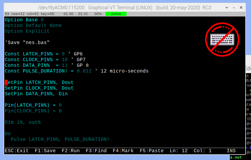

Hi Rob/folks,
I noticed that Editor syntax highlighting from the PicoMite is not display properly in GFXterm (20-may-2020, RC) on the Raspberry Pi.
Using "nes.bas":
   nes.zip
PuTTY shows:
GFXterm shows:
Note the incorrect colours starting at Option Default and again at Pin(CLOCK_PIN%).

   it seems the pico port of mmbasic is sending some really weird/obscure escape sequences to set text colours. many terminal emulators (including GFXterm) simply ignore such text colour/attribute sequences, as there are far too many variants to support them all and throwing an error would be 'unreasonable'.
here are a list of what i get from my pico (a25) with a typical page:
ok?      sequence             occurrences    effect/colour
yes     <ESC>[0m                    2       normal text (reset to defaults)
yes     <ESC>[32m                   3       green
yes     <ESC>[36m                  23       cyan
NO      <ESC>[38;2;128;128;128m     2       bright black (grey)
NO      <ESC>[38;2;192;192;0m       2       yellow
NO      <ESC>[38;2;255;128;0m       4       orange
NO      <ESC>[38;2;255;128;128m    29       pink
yes     <ESC>[4m                    2       dim foreground
NO!!!   <ESC>[97m                 150       bright white (aixterm standard)
the aixterm one (<ESC>[97m) is a doozy - i'm surprised anything supports that.

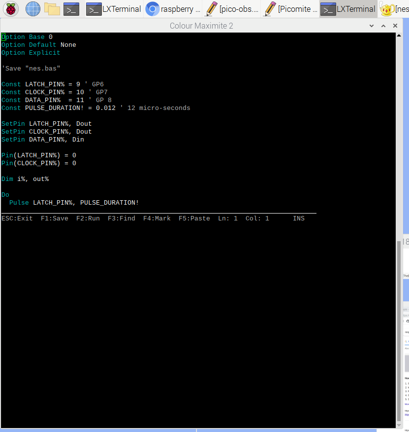

OK, no I haven't seen any other colours. The EDITors of the CMM1 and CMM2 both show the correct colours in PuTTY (though I believe the CMM2 EDITor source is completely independent of all the others) and I don't have any other 'mites to test on ... though BigMik is sending me one of his MX170 based-boards, coincidentally also called the Picomite
  matherp said  The PicoMite uses the same colours as other of my ports. It was a cut and paste. The standard MM2 colours don't work on a black background

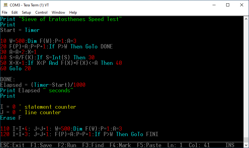

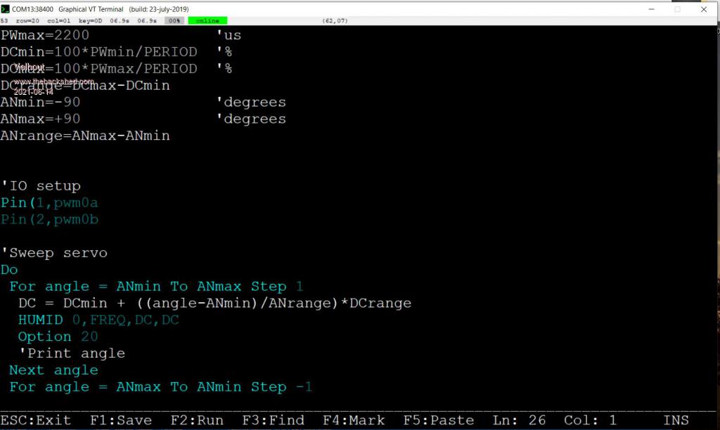

Posted: 12:47pm 14 Jun 2021

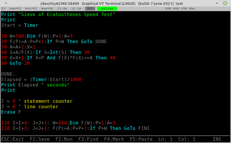

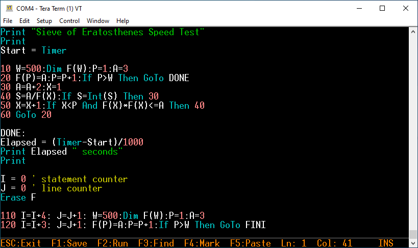

just realized i had a win10 netbook here that i haven't wiped yet, so did some experiments comparing teraterm to GFXterm. each has exactly the same code loaded onto an MX170 or pico.
GFXterm, MX170:
TeraTerm, MX170:
TeraTerm, RP2040:
note: TeraTerm has the palette change made so that grey text is visible.
the file sizes (screen captures), despite being roughly the same dimensions, came out quite different, with the one from GFXterm about 4x larger than the TeraTerm ones. i eventually figured out what was going on - while GFXterm uses font dithering for the displayed text, TeraTerm seems to turn dithering off. this is, partly, why the TeraTerm text appears to be less smooth.
rob   :-)

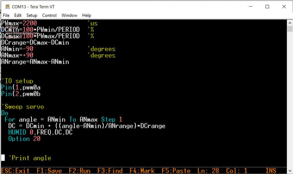

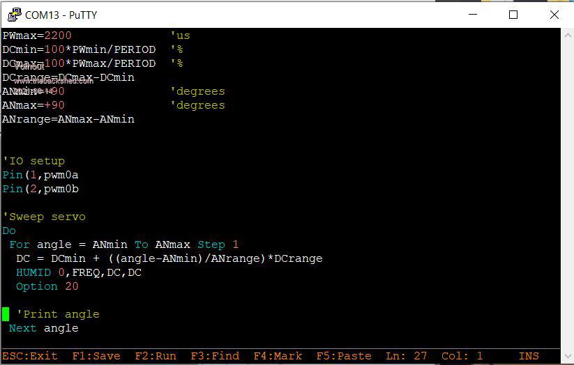

Posts: 6209
Posted: 01:13pm 14 Jun 2021
pi pico MMBasic a25
GFXterm windows
Putty Windows
Teraterm (windows ...)
Edited 2021-06-14 23:36 by Volhout
Posted: 01:22pm 14 Jun 2021
  Volhout said  GFXterm windows
Thank you; that is what I observed previously and is similar (if worse) than what PuTTY on the Pi does.
It seems the PicoMite, and presumably the Armmite, and maybe other recent 'mites (but not the CMM2 which has a different EDITor lineage) are "doing something different" to the earlier 'mites (as Peter has acknowledged). I only took a casual look at the Armmite source but it wasn't obvious why the standard VT100 colours were not being used ... the constants for them are still defined ... I wonder if the code-path/colours defined for rendering the console to an LCD panel are being used instead ?
I guess it is in Peter's court now if he wants to "fix" this.
