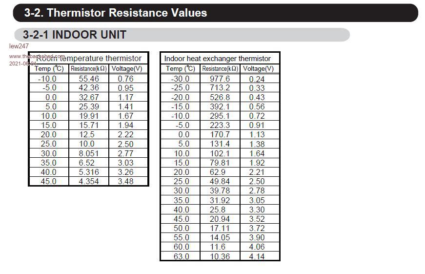

There are 2 thermistors in the wall unit indoors
One for measuring the room temperature and one for the indoor heat exchanger
I was going to try and make a wifi or bluetooth thermostat to control the aircon unit but there is no return feed from the IR so there is no way to attach it as far as I can see.
The one thing I did think of was replacing the thermistor for the room temperature with a proper temperature sensor and simulating the resistance somehow and possible being able to remote mount the temperature sensor nearer to where I sit rather than having it inside the aircon unit itself.
Does anyone have any ideas or suggestions?

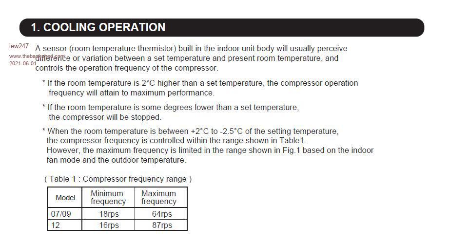

I've found this
and here are the resistance values and voltages for both thermistors at various temperatures

It is obviously an inverter unit so I don't think there is much you can do. The control does not just cut the unit in and out but as it nears the set temperature the compressor speed ramps down until it reaches a speed where it just idles away to keep the room at the set temperature It also has an electronic expansion valve that is controlled by the thermostat. I did work on them but retired not long after the inverter units became popular. I think you need to ask a Fujitsu technician.

A trick I have used is to fool the system into thinking the temp. is a little higher than the actual temp by adding some resistance in series with the thermistor.
Measure the resistance of the thermistor at both the lowest setpoint and at the temp. you want, then add a resistor equal to the difference. You will have to remember the temp. offset when changing the setpoint.

I think the best idea so far is to measure the resistance of the thermistor, and if it is working properly, try and move it outside the wall unit by extending the cable
not certain this would work but worth a try.
