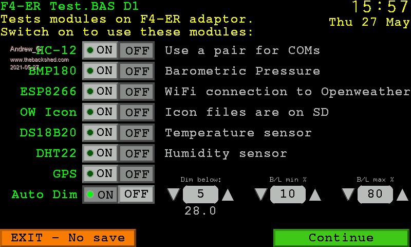

Andrew_G
Joined: 18/10/2016
Posts: 910
Posted: 06:19am 27 May 2021
Roger,
This a relatively easy menu created on an Eastrising 800x480 LCD.
It is using BigMik's F4-ER adapter to an F4 running MMBasic.
In this case it just turns on modules connected to the F4 - but they could be relays, motors or whatever.
Temperature in this case is provided by a DS18B20, a DH22 or the internet via an ESP8266.

rogerdw
Joined: 22/10/2019
Posts: 957
Posted: 03:12pm 27 May 2021
  Andrew_G said  Roger,
Thanks Andrew.
So you wrote the script for the display example you showed, or are there libraries of code to choose from and modify etc.
  Quote  In this case it just turns on modules connected to the F4 - but they could be relays, motors or whatever.
It automatically dims the LCD when the Light Dependent Resistor reading, ie "Dim Below", drops below 5 (it is currently 28.0) it will dim to 10% and the "Bright" value is 80% - all adjustable by MMBasic's GUI controls on the menu. The settings can be saved or abandoned.
That looks great. I can see myself using all of those types of interfaces. Thank you.
