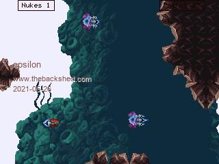

Hi all,
Attached is the first release of my Game Engine for the CMM2.
Some screenshots:
Here is footage of an amazing display of dexterity by self, holding my cell phone and recording in one hand, and playing the game engine's demo game in the other:
https://youtu.be/qD5m2_azJWo
API and demo code are reasonably well documented. If there's any interest, I'd be happy to provide more documentation about the Game Engine and toolchain used.
See README below for more info. Any feedback is more than welcome.
Cheers,
Ruben/Epsilon.
