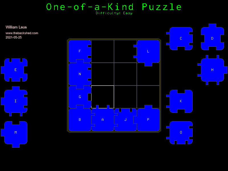

Here's a new program, the "16 Puzzle". Your task is to assemble the 16 pieces so that they fit into the square frame with no gaps or overlaps. You can choose from 4 levels of difficulty.
Enjoy!

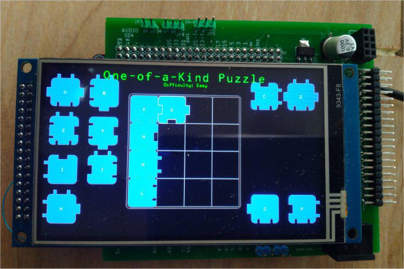

Nice. Also, for once, trivially easy to port to the Armmite F4.
While the CMM2 implementation can use a mouse, everything can also be controlled from the keyboard. But it was set up to use a plugged-in USB keyboard, not the PC console. So I replaced all instance of inkey$ with _inkey$(), and added this function:
Function _inkey$()
 local ky$
 ky$=inkey$
 if asc(ky$)=27 then ' escape sequence
   ky$=inkey$: ky$=inkey$: ky$=ucase$(ky$)
   If ky$="A" Then: ky$= chr$(UP) ' chr$(128) ' up arrow
   ElseIf ky$="B" Then: ky$= chr$(DOWN) ' chr$(129) ' down arrow
   ElseIf ky$="C" Then: ky$= chr$(RIGHT) ' chr$(131) ' right arrow
   ElseIf ky$="D" Then: ky$= chr$(LEFT) ' chr$(130) ' left arrow
   ElseIf ky$="1" Then: ky$= chr$(HOME) ' chr$(134) ' home
   ElseIf ky$="4" Then: ky$= chr$(ENDE) 'chr$(135) ' end
   ElseIf ky$="5" Then: ky$=chr$(136) ' pgdn
   ElseIf ky$="6" Then: ky$=chr$(137) ' pgup
   ' Function keys are ???
 endif
 _inkey$=ky$
end function
This has the advantage of also allowing it to run on the CMM2 with PC console and VGA output to VGA-HDMI converter and HDMI-to-USB3 with Windows camera.
I did not run it through all its paces, so there may be something missing.

Thanks, Bill. This is a large and complex program you have provided--over 1200 lines. It's a tribute to your work and to the design and extension of MMBasic that by making a single change (replacement of a built-in function with a custom one on 10 lines) and adding 19 lines, it works on an entirely different hardware platform.
