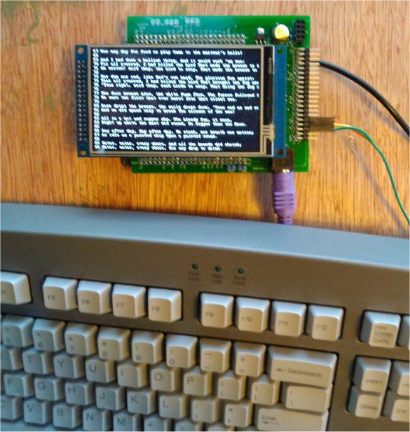

Here is a doodle--the F4 takes serial output from a CMM2 @19200 (or other micromite, or PC or other serial outputter) and displays it on the LCD. In this case, it is an IPS 800x480 LCD.
You can scroll back and forth on the display: <Home> starts the display at the first line; <End> ends it at the last line; <PgDn> moves down a screen's worth of lines; <PgUp> moves up; <UpArrow> moves up a line; <DownArrow> moves down.
The default is to use font 2, which provides 24 lines by 66 characters on the IPS display; <LeftArrow> switches to Font 1, 36 lines by 100 characters; <RightArrow> switches back to Font 2.
It does, sort of, what TeraTerm can do, but without necessarily having a PC attached.
It works with local keyboard as well.
In this configuration, I am using not only the IPS LCD adaptor but also the F4 2x20 hat PCB with PS/2 keyboard connector.
Wherever you have located the view, if a new line comes in, that and the preceding lines display. If a line is added when the previous last line is already displayed, I first blitted from the second line through the last to the first line and then added the new line, but it appears to be faster to clear and TEXT write all the lines.
