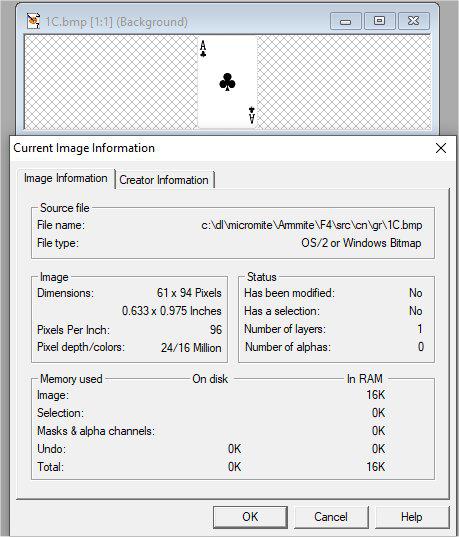

For a deck of cards, I've converted bar1010's deck in CMM2 Concentration Game from PNG to BMP using PIXRESIZER.
The images display fine on my PC, but don't appear at all on the F4.

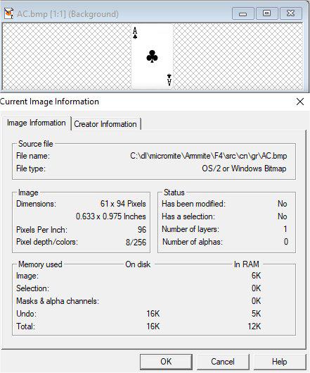

This is what PaintShopPro reports for image information--pixel depth 24:
If in PaintShopPro I reduce the color depth to 256 colors, the image displays as expected.
The manual indicates that a "24-bit true colour BMP file" should work. What is it about my first file which makes it not display? (I'll go through and reduce all 53 bmp files to 256 colors, but just wondering why the other didn't work.)

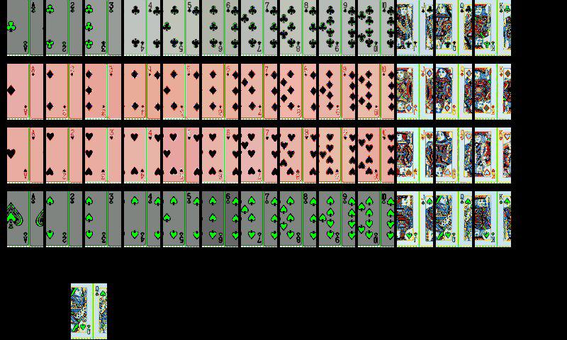

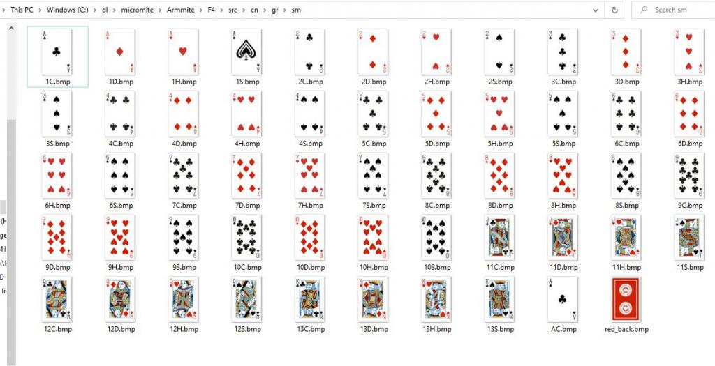

After I reduced the color depth in each file, they displayed fine on the F4, but were larger than I wanted. I resized them with GIMP. This is what they look like in Windows Explorer:
But this is what they look like when I display them on the F4 with the following code:

What is happening?

  matherp said  Use something other than PIXRESIZER
That's why I tried Gimp--to see if it would do better. The images displayed, but were shifted and included extraneous colors.

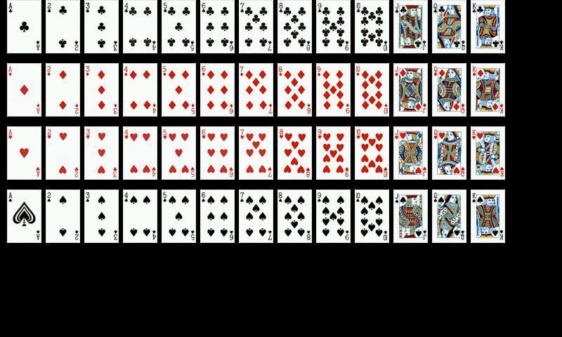

I resized again with PIXRESIZER to the final size I want, and again brought each file into PSP and reduced the color depth to 8 bits.
That worked:

I don't care what PaintShopPro thinks, your original BMP file is 32 bit (24 plus alpha)
Windows file manager knows.
That is a common problem when converting from PNG to other formats.
One simple way to convert would be to use CMM2 to display the PNG then save as BMP.
Repeat for all files in the folder.
I don't have an easy way to bulk remove alpha.
For individual files, I open in Windows Paint and save as BMP. This gets you to 24 bit.
