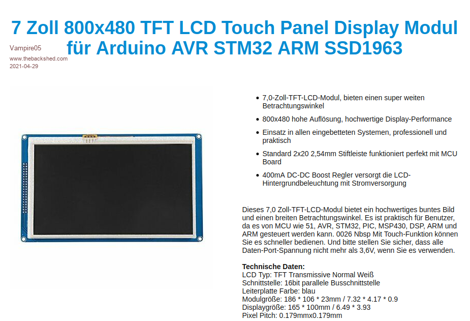

Hello People,
is this 7 inch Display 800x480 compatible with the Armmite F4 (STM32F407VET6):
it would be great to have one list with all Micromite Display Options

Yes
See my post here for details of how to wire and an adapter. Note you need a good 5V supply for the backlight

  Vampire05 said  it would be great to have one list with all Micromite Display Options
Links to some F4 LCD adaptors F4 on Fruit of the Shed
Also see FOTS here

Wow, Thank you very much guys.
@lizby: Fantastic pages
I have ordered that 7" Display and STM32F407VET6 for my Homeautomation Project.

Check out the breakout PCBs for the F4 on that first FOTS link:  "Armmite F4 Hat PCB: expansion port, keyboard, ESP-01, Audio, SPI TFT" and "F4 Experimenter's PCB: F4/CMM2 40-pin connector breakout".
You can order those boards and matherp's SSD1963 adaptor from JLCPCB for about $20US including slow boat shipping, and they will give you convenient access to a lot of pins and I/O functions. Various headers and some fairly easy soldering required.
To put it another way, if you order the matherp SSD1963 adaptor for the F4 from JLCPCB, for $8 more you can also get 5 each of the F4 Hat and the 2x20 breakout PCBs.
