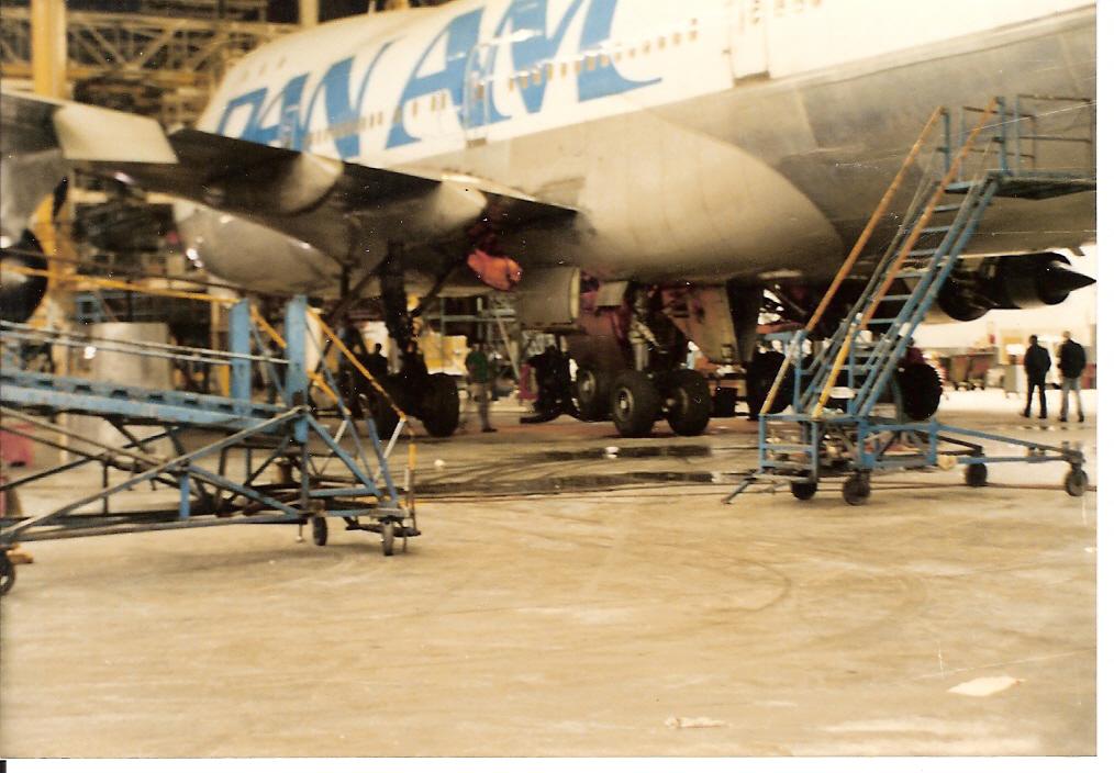

@PeteCotton .... Pan Am inherited a few L1011 aircraft from the defunct National Airlines about 1982 and then ordered the first group of 28 L1011-500 aircraft with the improved Rutan inspired wing which were delivered beginning about 1984. Until then we only had twin spool engines made by Pratt & Whitney.
The RB211 is a unique triple spool engine. The triple spool design was necessitated by the short engine bay for the number 2 engine in the L1011 fuselage. I had very exacting fuel control requirements to keep turbine temperatures within design limits. These are the limits you and your brother are dealing with when you test run these engines.
It was a very difficult engine to design and resulted in the bankruptcy of Rolls Royce and the final decision by Lockheed-Martin to stop trying to build commercial airliners.
Thanks to the support of the British government Rolls Royce emerged from bankruptcy and the RB211 engine, along with a GE variant, is currently still being used in new construction of aircraft by Airbus and Boeing.
Pan Am never did fully implement overhaul facilities for the RB211 since we only owned about 52 of them including spares. We concentrated on rebuilding the P&W JT9 of which we owned up to 346 engines including spares at one time. We did construct a high power test cell for the JT9 / GE CF6 engines right next to the two test cells for the earlier JT3 and JT4 engines. Those test cells are still standing at Kennedy airport but are currently unused. You see the test cells here LINK
I am bewildered by your location (GMT+10) in western Canada and your requirement to test run RB211s. I know that Air Canada uses RB211s on AirBus and Boeing twin engine aircraft but I thought that their main base maintenance was located at Toronto YYZ although they do have a hub at Vancouver YVR. Have you constructed a test cell or are you running them outdoors?
(They would probably be very good at clearing snow. I am now retired and living near Poughkeepsie NY. I am currently evaluating the purchase of a snow blowing tractor since the guy who plowed my 250 foot driveway for the past 20 years died last week. Got any tips?)
