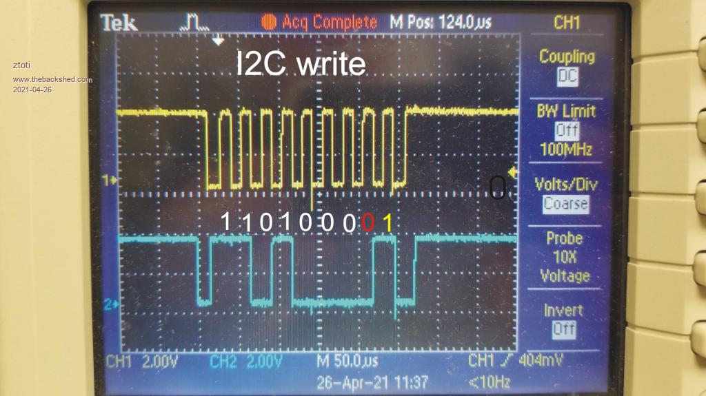

I did troubleshooting and I saw that the PIC32 send to the ADC just one byte information (just address with 9 clocks), please see the picture.
The command: I2C write &B1101000,0,conf_byte
conf_byte = &B10000000   ' ch=1,one shot,12bit,G=1

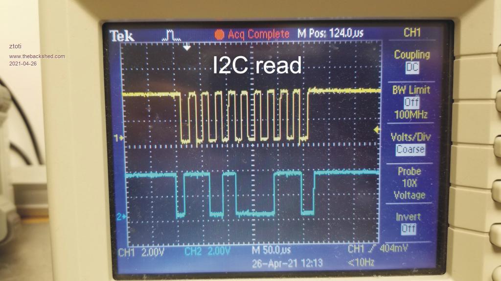

The result is on the picture. The last bit (the yellow color) on the picture is always "1" for I2Cwrite and I2Cread, the red bit is "0" for I2C write, but "1" for I2C read.
Doesn't matter what number is conf_byte, the result is always same as on the picture bellow.
Any idea what I do wrong?
Thank you
Z.

If you are only seeing one byte then this suggest that the address or the wiring is wrong and the uP is not seeing the ACK after sending the address. Check the address set up of the chip, the pullups are in place and that SDA and SCK are the right way round. What does mm.i2c report?

Your address is wrong - should be
I2C write &B1101000,0,1,conf_byte 'note 7-bit address not 8
Edited 2021-04-27 00:04 by matherp
