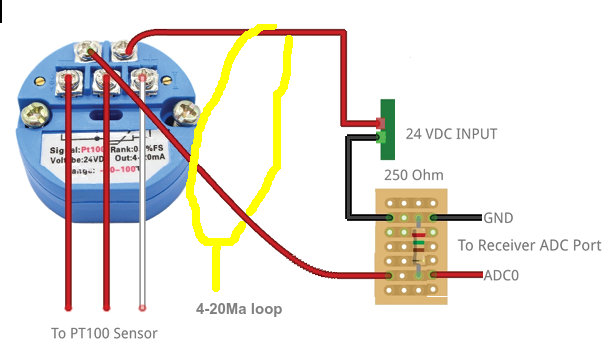

try the PT100 to 4-20Ma. change the 250Ohm to match the ADC max.
I have seen a few job sites where they used 12VDC. Not sure if they made
any other changes.
 4-20Ma is Great in noise environments.
Edited 2021-04-23 18:47 by Quazee137

A lot of electricity generation systems (also noisy) use 4-20mA signals for engine and alternator temps (and you can get 4-20mA current transformers too - you'd think that was asking for trouble!) so that's also well worth considering.

I've used 4-20 loops before (on the Explore 100, implemented using the 'click' range of boards) and have been impressed with their performance in harsh (electrical) environments. The downside - they are expensive and require non-trivial extras to work.
Not that my goal is cheap. My goal is more 'simple as I can get away with'.
