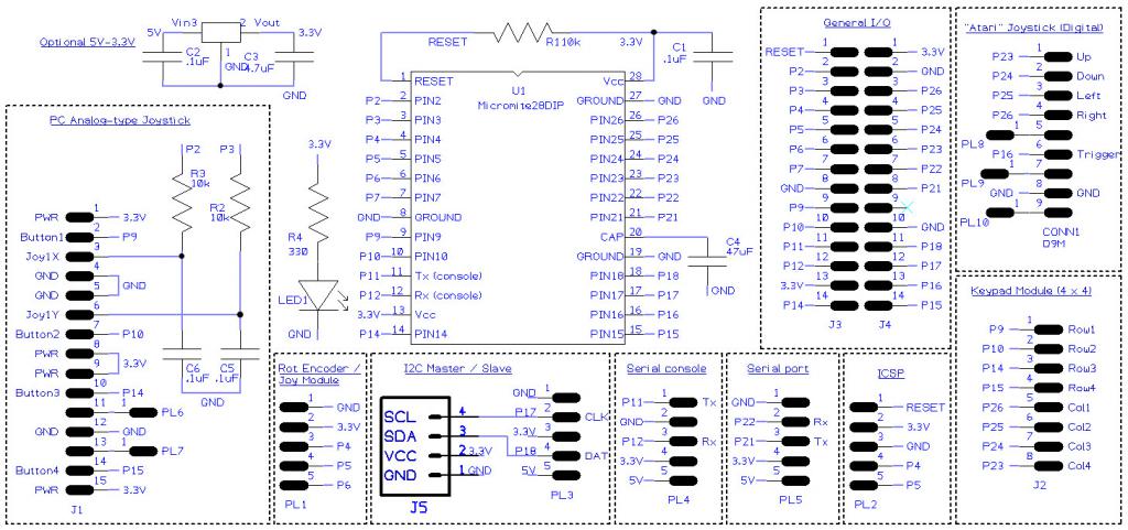

I have to admit that I am not much of a video game player. I had a console in the 1970s that had Pong and a few other games on it. I played those a lot, but after that generation of monochromatic games I played very few.
But I have had a lot of customers that have requested a joystick port for the CMM2 (RetroMax that I sell) and I decided to throw together a little board to be a joystick interface.
The features:
 Based on MMBasic '170 so it can be user programmed
 Support Atari (digital) joystick
 Support PC (analog) joystick
 Operate as I2C slave interface
 Operate as serial interface
 Support 16 key keypad
 Support rotary module
 Support analog joystick module

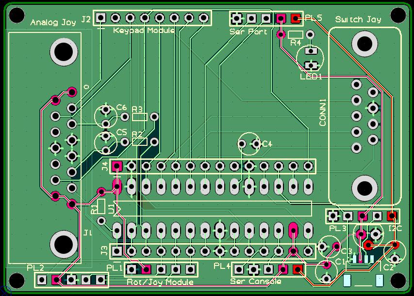

The PCB layout will be all through-hole so the end-user can populate whatever parts he/she needs. When done with the PCB layout I'll post the Gerbers here on TBS.

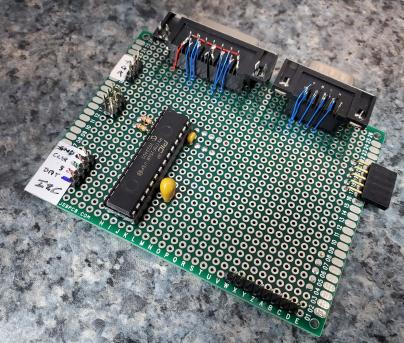

Here is a cobbled-together prototype. I jokingly call it a NONchuk. It's little more than a '170 and connectors. I've connected it to joysticks etc to test.

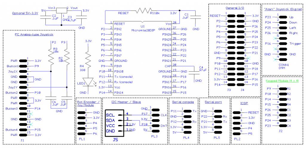

Here is the current schematic.
What I'm looking for is feedback from the minds here on TBS that have worked with joysticks before. Take a gander at the schematic and let me know if I'm off base.
It won't need a program on it that does everything, as new programs are easy enough to install. The CMM2 can address this slave I2C device with simple commands. I'd be interested in knowing if anyone is willing to make this device act like a Nunchuk so that the CMM2 can be fooled into thinking that a PC joystick is a nunchuk.

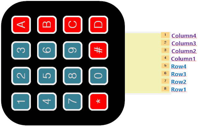

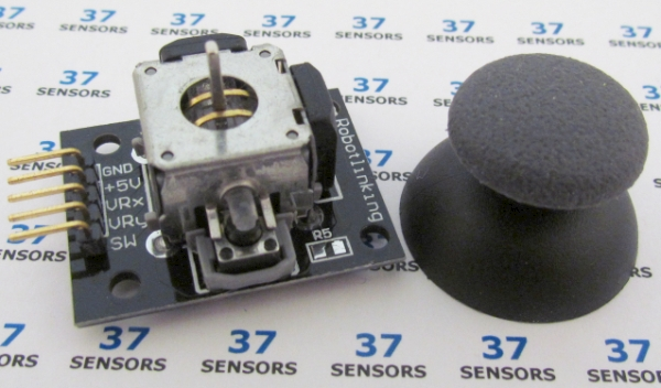

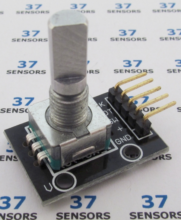

The keypad, analog joystick module, and rotary input are like these:

Nice project. I also have played almost no computer games other than Pac-Man and space invaders on a Xerox Alto-Bravo system in the early 80s, so I am hopeless with the arcade-style games.
However, I am interested in joystick control. I've found the "37 Sensor" joysticks to be almost useless except for the grossest control. Do you have a recommendation for a more sensitive one?
CircuitGizmos
Joined: 08/09/2011
Posts: 1427
Posted: 05:23pm 14 Apr 2021

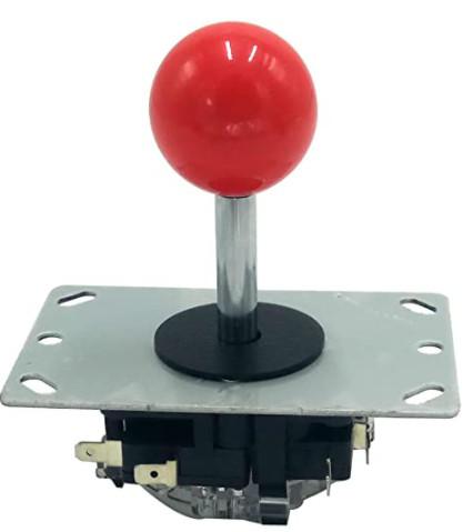

I remember seeing "arcade size" analog joysticks. (most arcade size ones are just switches, not pots) Visually this:
But not digital. Harder to find.
Amazon has these:
I've never tried them.

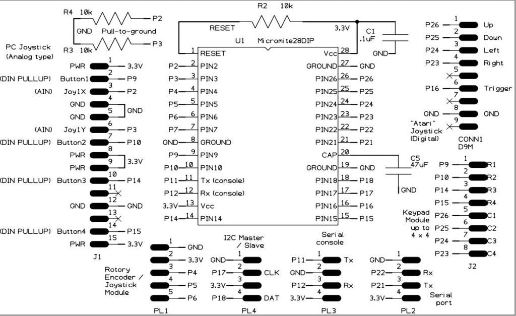

I can't see any obvious changes to make to your circuit.
I am not a gamer and have only really worked on the IBM style joysticks.
I did come up with a method of auto-detecting and swicthing between IBM style and 'normal' analog sticks.
I went with just the IBM 15 pin connector.
I should have a couple of Atari joysticks somewhere in the shed but I haven't found them yet.
Something that is really useful for the 'normal' analog joysticks is some way of auto centering them. The IBM ones have trim-tabs so they are OK but for the normal ones, I read the voltage on startup and assume that the joystick is centered during that time.
Deciding which of the many fields of the Nunchuk protocol get mapped to the various inputs is an interesting conundrum.

The Atari joysticks are just plain switches. The up/down/left/right/trigger are pulled high by internal '170 resistors. Joystick operation grounds the line.
The PC/IBM analog joysticks need the 10k to ground, from what I gather. The other analog type can be treated as just an input voltage to an analog '170 pin.
My opinion is that the input centering can be done in the host (CMM2) software. The host could also decide what the "dead" range is for centered input. But emulating a nunchuk would be different, right? Perhaps a host calibration program.
You are right about the nunchuk input. I was hoping someone with more nunchuk knowledge could make some of the various inputs "look" like a nunchuk. Then this board could be used for various games without the game knowing any better.

  CircuitGizmos said  The PC/IBM analog joysticks need the 10k to ground, from what I gather. The other analog type can be treated as just an input voltage to an analog '170 pin.
When I was experimenting with this a while back, I never got good results trying to use a PC joystick with a resistor as a voltage divider. No combination would give both good range and linearity.
Instead, capacitor timing worked well. I settled on a capacitor (marked 103) from the joystick axis pin to ground and a 2k2 resistor from the joystick pin to the MCU input pin. (MCU was a PIC16F18345 running at 5 volts.) I2C output emulating a Nunchuk worked nicely.

IIRC the PC analogue joysticks were a 100k or so variable resistor from 5V. That fed a capacitor on the input of a monostable, so it set the time delay after the port strobe signal. There was no resistor to ground so linearity wasn't awful. It was a nice cheap system with no analogue inputs needed. :)  That would tie in with what you found, vegipete.

  Mixtel90 said  IIRC the PC analogue joysticks were a 100k or so variable resistor from 5V. That fed a capacitor on the input of a monostable, so it set the time delay after the port strobe signal. There was no resistor to ground so linearity wasn't awful. It was a nice cheap system with no analogue inputs needed. :)  That would tie in with what you found, vegipete.
That makes some sense. Perhaps with the '170 there is a better input pin? Has this been done on a '170?
Posts: 9273
Posted: 07:21pm 15 Apr 2021
It's been done on other PICs. I remember having a pot input using this method on a PIC16C84. :)
Set pin to output low to discharge cap. Start a timer & set pin to input. When it goes high stop the timer. The length of time is proportional to the joystick resistance. The 170 should be good for this as the pins have pretty well defined operating points.
I bet there's some info on the IBM analogue sticks somewhere...
Ah-ha! http://vintage-pc.com/pc_analogue_joystick.html
