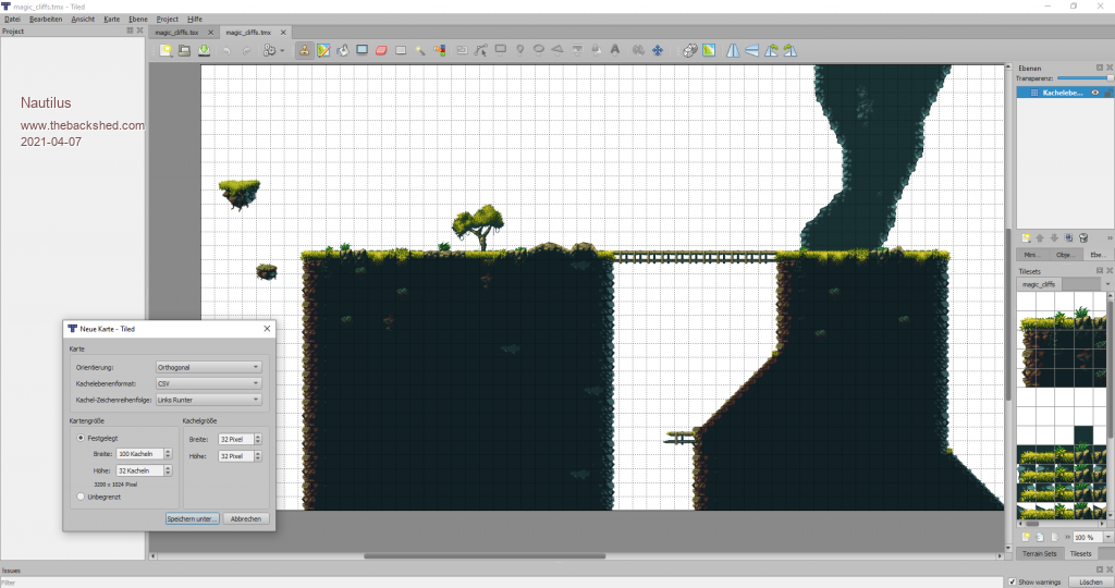

Yes - the TILED map editor is your friend   ( https://www.mapeditor.org/ )

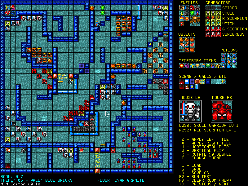

Meanwhile, I suffered developing a map editor only to have the experience creating maps directly on the CMM2... But for sure this isn't the most recommendable experience to speed up the development of a 2D game.
Now I'm seriously thinking about quit making another map editor to the INTO THE DARKNESS game.
