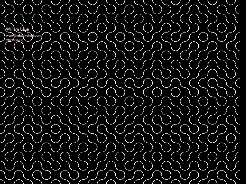

I'm tired of wrestling with the code for some of my more ambitious CMM2 projects, so here's a tiny little program that creates a sort-of maze using Truchet Tiles (see Wikipedia). It has a very close relationship to the famous one-line Commodore Pet maze generator known as '10Print'.

Here's a slight variation. I fudged the numbers slightly to get joined arcs, extended the loops to go past the screen edges, put a box around the perimeter and added a flood fill to colour a portion of the 'maze'. The red dot shows the start of the flood fill. Press any key for another image, [Esc] to quit.
Edit: added the option for corners instead of curves. Press "1" to change to corners, "0" to change to curves.
It would be handy to know how many pixels the flood fill command actually drew...
