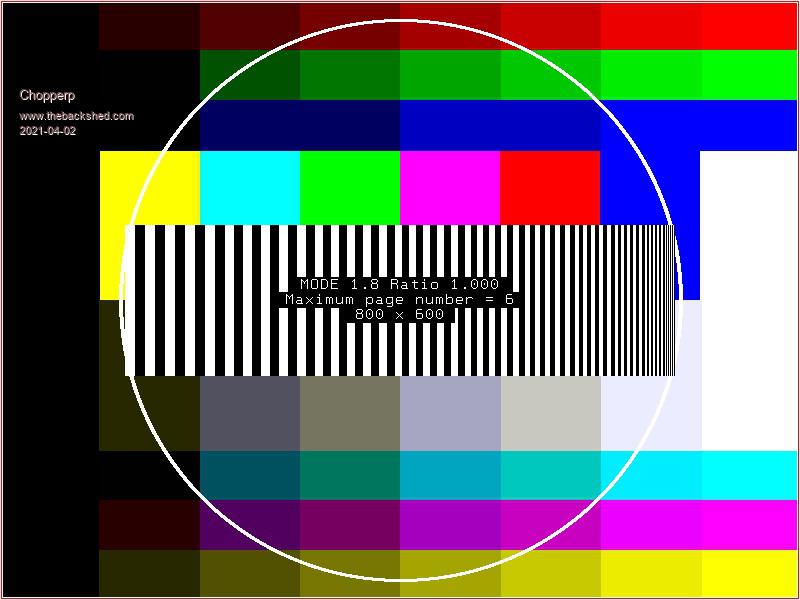

Chopperp
Joined: 03/01/2018
Posts: 1139
Posted: 01:17am 02 Apr 2021
OK, had a bit of a play with the monitor.
About the best I could get it. It was worse.
Conversion to JPG makes it appear a bit worse than it is.
Brown & Red still much the same.
Great test card...
Brian
OOPS
Just realised that the IMAGE saved may be NOT what is on the screen...
Edited 2021-04-02 11:31 by Chopperp

Posted: 02:32am 02 Apr 2021
  Quote  OOPS
Correct.
But if you view the saved image in Windows paint etc and compare it with what you see on your monitor, they should be close to the same.
also try 16 bit for a check of the full R2R network
Chopperp
Joined: 03/01/2018
Posts: 1139
Posted: 03:06am 04 Apr 2021
Got around to playing with Jim's Test Card program on my other CMM2 running a wide screen monitor. Also read the instructions on how to use it...duh
Re-adjusted the monitor settings to give a better picture. Found that depending on what angle you look at the screen determines to some extent what colours are seen. If I got the right angle, RGB(BROWN) did look OK.
Interesting going through the various modes & resolutions on the CMM2. Hadn't done that before. (No need to). Mode 11.16 looks good.
Will re-check the other CMM2 one day soon.
Thanks again Jim.
