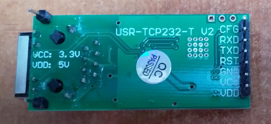

EDIT: So these modules want a dual supply, yes?  IE: 3v3 and also 5v?  That's what I interpret from the bottom silkscreen.

Posts: 12084
Posted: 10:29am 28 Mar 2021
  Quote  Out of interest, matherp, have you used the module you linked to above and if so, how easy(or not!) did you find it to work with?
No - just connect to the one that works for you
