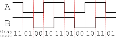

A picture always helps: (from the web)
This shows us that the 2 pins outputting the signal have the repeating sequence of values 0,2,3,1
The PORT command is ideal to output this.
DO
  PORT(<pinnum>,2) = 0
  PAUSE 0.5
  PORT(<pinnum>,2) = 2
  PAUSE 0.5
  PORT(<pinnum>,2) = 3
  PAUSE 0.5
  PORT(<pinnum>,2) = 1
  PAUSE 0.49
LOOP
This should output a quadrature signal on pins <pinnum> and <pinnum+1> at about 2 kHz. (I fudged the last pause command to account for loop overhead. YMMV) For the reverse direction, send 1,3,2,0.
This should be checked with an oscilloscope to confirm the signal is clean and as expected.
I would store the 4 values in an array, and step through the array.
Also, a differential signal would easy to generate by extending this to 4 pins in a row and using the sequence 12,6,3,9. (Examine the binary representation to see where these come from.)
