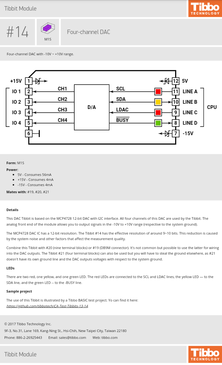

Only bringing this up as a FYI.
I did a search and found no mention of it but it's a cool 12 bit, I2C, 4-channel DAC. I have it doing rail-to-rail, +/-10v.
The default settings are perfect for my application and so I have no library to post at this point. Maybe I can revisit when the heat is off.

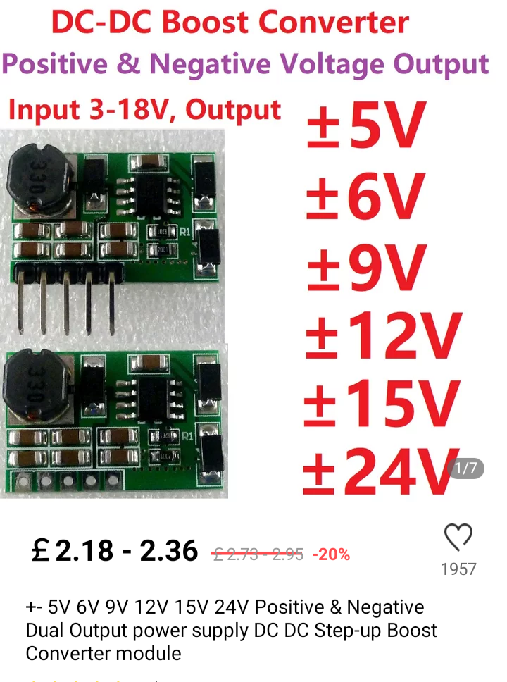

Posted: 08:15pm 21 Mar 2021
How are You getting + / - 10 V
with a 5 V supply ?

Posted: 08:42pm 21 Mar 2021
Yeah but from one of these devices which I am kinda impressed with:

Available here, for example.
Posts: 6209
Posted: 07:02am 22 Mar 2021
Hi Tinine,
What amplifier did you use? The device is 5V. Are you using the MCP to drive the switchmode convertor Vref pin ? Or are you powering the convertor with the MCP.
For these cheap convertors, please understand that the +12V output has feedback, and will stay more or less accurate. The -12V is auxiliary voltage that more or less tracks the +12V, but it has no feedback. Therefore it will not be accurate.

I should have mentioned that the 4728 is incorporated in a "Tibbit" module from tibbo.com.
Converter:
Yes, I have found the same characteristics with other converters as well.
It's not a problem (although I don't intend for this device to go any further than my proto board) because this is a closed-loop motion controller and my PID loop updates the DAC every 2ms to track the motion trajectory. Industrial servo drives accept a +/-10v motor command.
This is my first actual DAC device as I normally LPF a PWM but I am up to 4 axes on a single MX170 and I need the PWMs for other purposes.

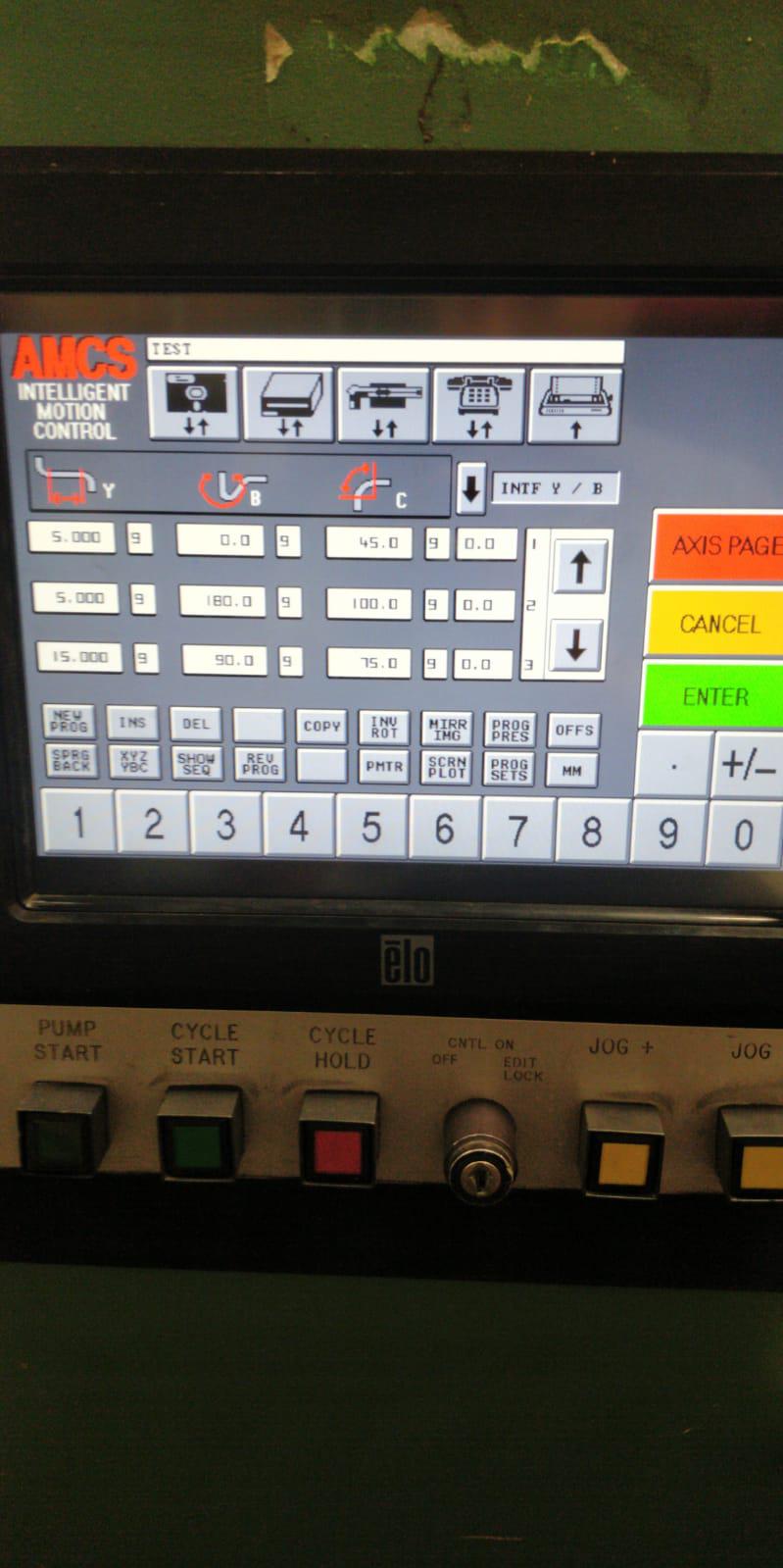

Posted: 11:15am 23 Mar 2021
  Volhout said  A PC supplied 30 years ago ....
Must have been running MSDOS. Yes, those machines where near indestructable, only the media interfaces (floppy, maybe harddisk) might have wanted attention, and the fan (in the power supply, not on the CPU at that time). But if it had been running 24/7 this kind of lifetime is possible. The fan would have stopped 10 years ago, but the power supply would have survived for another 10 years.
It is hard to imagine, but there are still MSDOS applications running these days....
Yeah, MSDOS, puny CPU and 1MB RAM. Microtouch capacitive touchscreen and EGA (640 X 350) graphics. Hard drives always worried me so I created a RAM drive with the upper 384K RAM and stored my GUI screens there to avoid accessing the drive.
This one in Ohio got a new drive and an ELO-Touch monitor in 2019 and it's good-as-new.

Posted: 11:50am 23 Mar 2021
OK, this is for a wire bending machine (spring bending).
Nostalgia ... the floppy and telephone(modem) symbols.
You must be proud (and should be) that you created something 30 years back, that is still in use.
Nowadays people talk about green, sustaining, the environment, but throw away 42% of their food, and every 2 years buy a new telephone.
This is good example of sustainable....

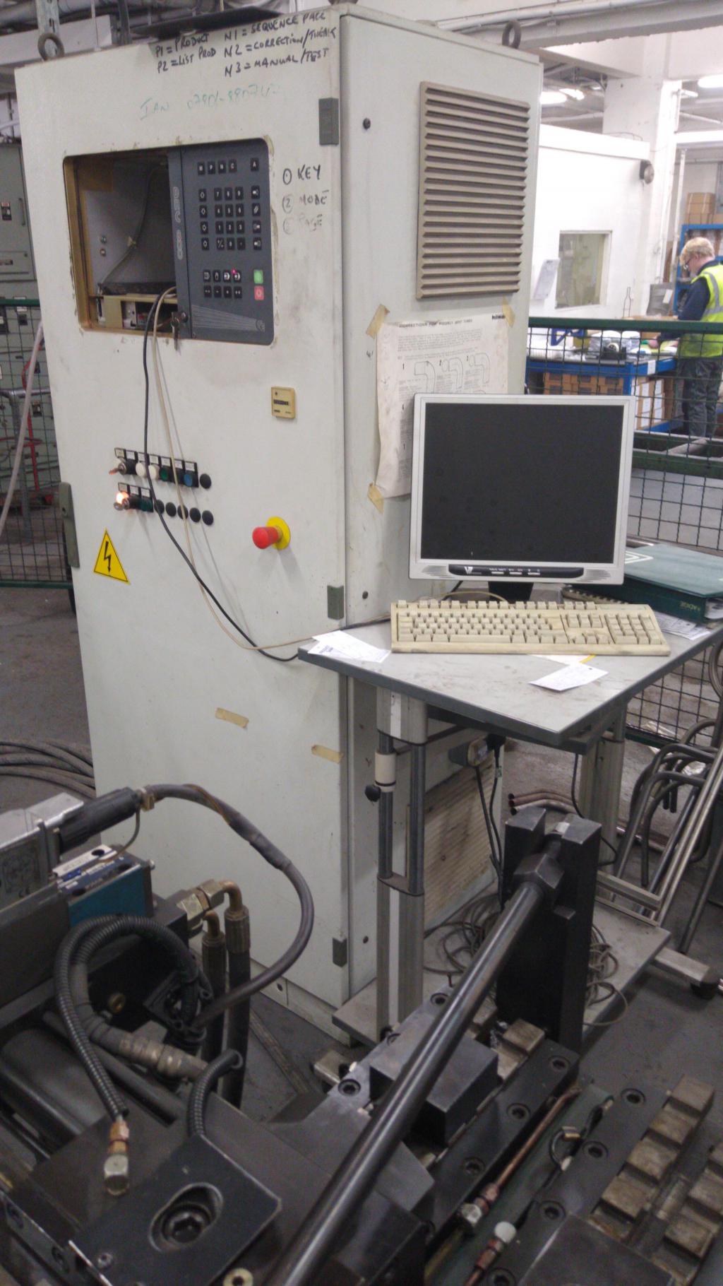

This is what is happening, all over the world:
Big name metal-forming CNC; Cybelec, Switzerland. User interface dead and now hobbling along with a PC screen/keyboard. The machine dies and the company is crippled. 250K and 6 months for a new machine...and this is only a baby model.
I replace the whole thing with a ubiquitous Android tablet and my motion controller. Clients love this
