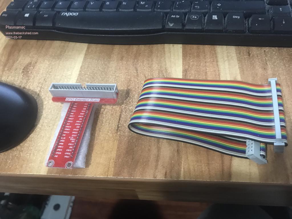

Same idea here   . I bought this
Plasma

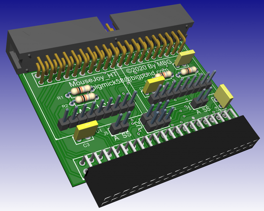

Hi Nimue,
How far do you need to extend the GPIO bus?
My PCB that accommodates 2 x HobbyTronics USB Host Modules (for USB mouse/Joystick etc) would allow approx a 50mm extension (without the HT modules)
Here is a picture without the HT modules installed.. You wont need the other components just the Male and Female R/A headers to be a plain old extender.
