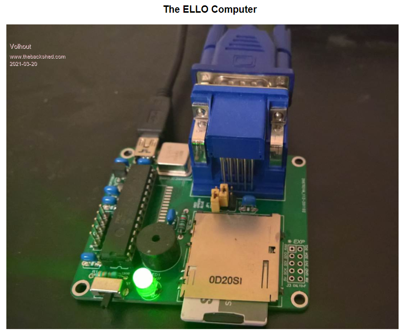

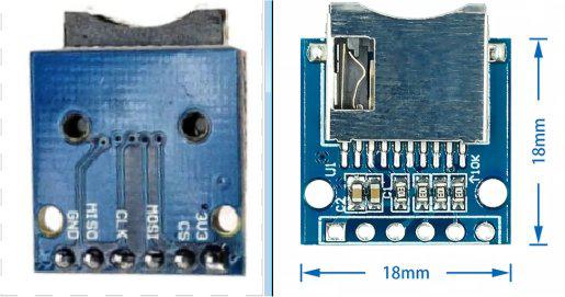

When I ordered parts, I neglected to order the SD card module. I have a number of these micro SD modules:
Would that be relatively easy to fit instead, perhaps using the J3 connector, which has MISO, MOSI, and CLK?

Posted: 03:54pm 19 Mar 2021
It's the right thread. I neglected to order the SD module, labeled 0D20SI on your photo. I'm wondering if I can expand the 2x5 header socket next to it (adding CS) to use the micro SD module I posted the photo of (which I've successfully used in several other circumstances).

You can connect an SD card to the expansion pins on J3 and use RA0 instead of RA1 (which is the default in the schematic). Then you should be able to use the SD card as SD2: device. The software won't switch to it automatically if there is a card in the slot, as it does with SD1, but at least you would be able to operate an SD card.
I don't have a module like yours with me here to test right now; if there are issues please let me know. Thanks

I soldered the other components on this morning, flashed the hex to a MX170 using Bigmik's Mup V3 with pic32prog.exe, cobbled together a connection from the purple DIN connector to a usb/serial module, plugged in power, flipped the switch, got a "password:" prompt, hit <Enter>, and I'm in:
ELLO 1A

One thing I forgot to mention earlier - when you use RA0 for SD2, you will need to add an external pullup resistor to the port.
You switch to SD2: with command ./cd sd2: (or ./chdir sd2:)

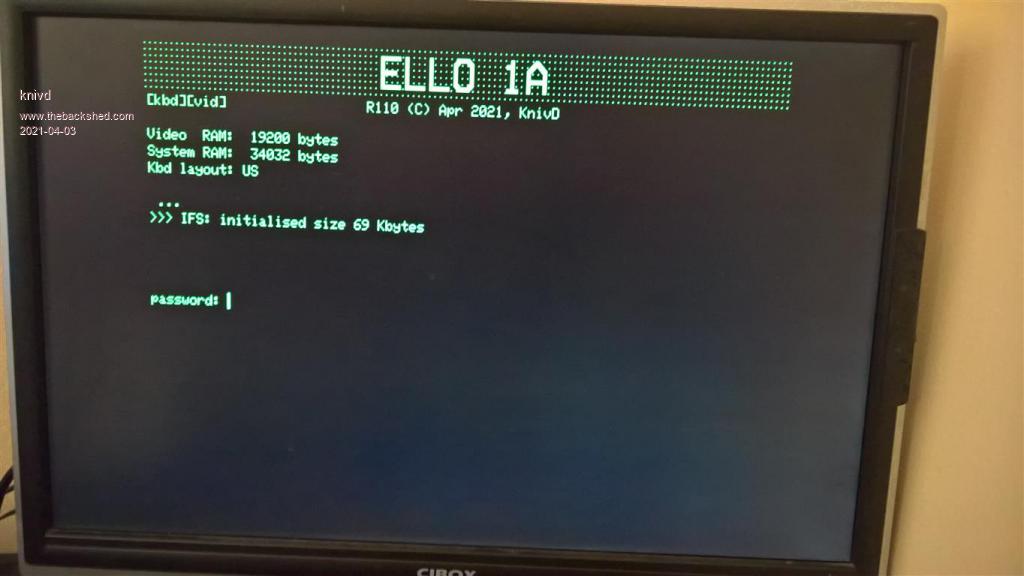

Regarding the VGA connector, yes it is a bit difficult to get it to fit all the pins at once. Not much I can do about that, except probably to make the holes a bit wider in the next PCB revision.
You can clear the program with a RIDE command .1d!
I admit there is a lot more to be written in the documentation and will gradually fill the gaps in it, especially regarding the RIDE commands and functionality.
The most important commands there are .o .w .p (also .pp in case you want pause), .l (and .lp). The reason for the way it is, is because it is not linked specifically to any type of hardware, display, or to the C interpreter, but is also a normal text editor of line type. A good relative to it could be the well forgoten gen from the MS-DOS era - edlin, alrhough RIDE has much more functions. Yes, it is unusual, but once understood it can be very efficient. Obviously being very new and written from scratch, I expect to see and fix bugs in it...
For C libraries, you can use the command ./lsl <lib_name> to see what is inside them. For reference to the standard C functions (C.impl follows the standard model), you can use https://www.cplusplus.com/reference/clibrary/
There are other online references as well (cppreference.com, cprogramming.com, etc.) as well as countless books and articles.
I will post some sample programs when I find enough free time to write them... ;)
Anything particular you want to see?
