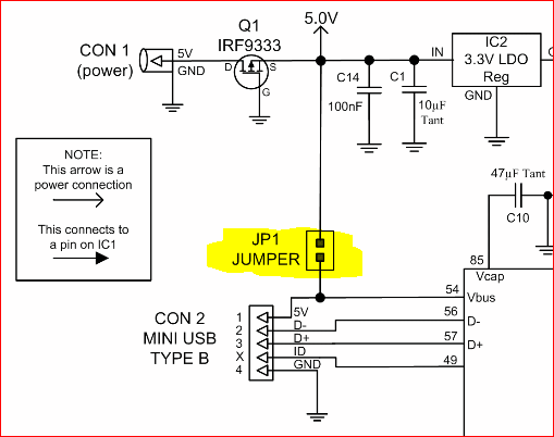

Posted: 09:52pm 22 Mar 2021
Look at the documentation... There is a jumper you need to install before the USB Vbus is allowed to run the E100 board...
It's located next to the USB connector...

I finally received my screen, but when I feed my maximite with usb nothing is displayed. Jumper JP1 is in good position.
Can you tell me where is the problem ?
Posts: 10078
Posted: 10:02pm 05 Apr 2021
Bonjour.
It is NOT advised to run the E100 WITH LCD FITTED, if you are using only USB power, as the USB port often cannot supply the current that the LCD wants to suck, and you can have issues.
Once you fit a screen, you should use an external 5v REGULATED power-pack/wall-wart capable of supplying AT LEAST one-amp of continuous current.
REMOVE the solder-blob on J1, and use a power-pack plugged into CON1.
That done, you will need to configure the E100 to use the LCD screen.  Please see THIS THREAD for the common setup commands.
You will also need to calibrate the touch using GUI CALIBRATE before you can use the touch-screen feature.
Do you have BOTH manuals?  The standard one, and the advanced one?
The standard one covers all the 28-pin and 44-pin micromite commands, and the advanced one covers all the GUI controls on the MM+ series of chips.  You need both manuals, as the E100 board is backwards compatible with all the 28-pin and 44-pin commands, and they are NOT repeated in the advanced manual.
