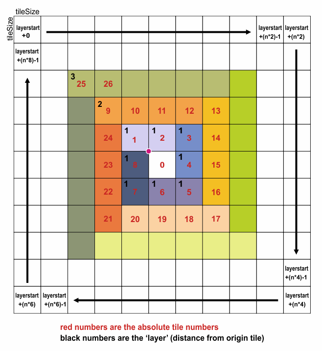

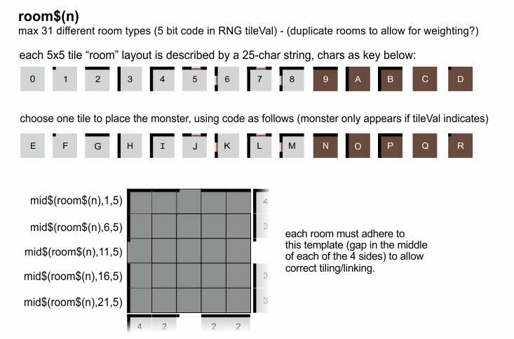

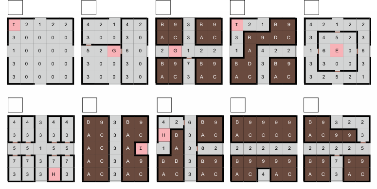

As previously mentioned on my facebook post - for those who are interested, I've attached the .bas file (zip file at end of post) - and some of my scribblings on how I put the procedural generator together.
