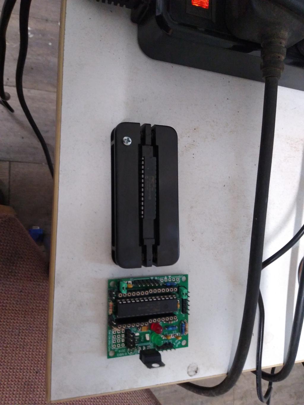

Just built 5 MuP V2s and I put the female headers on both sides but dammit....getting the MX170 pins lined up
was a biatch  . Definitely not my idea of table-ending
Took a wild stab in the dark and sure-enough, they exist. Am I the last to know this?

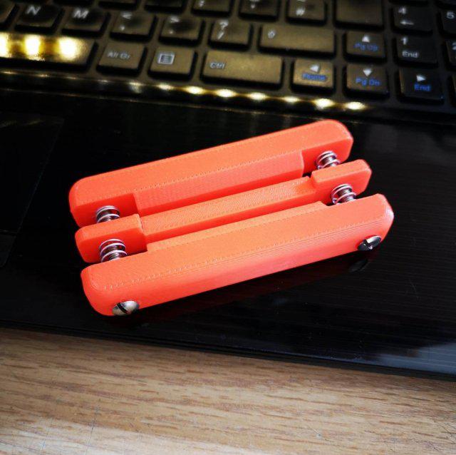

nope. I Printed one a few years back. Bright orange so I can find it in my tray of little used tools.
Loads on thingiverse ... the top left one looks like the one I did.
I used one loads 40 years ago when I was employed in hardware design&Build and it was all discrete DRAM chips and 74LSxx stuff (lovely) but lost it... then I went a different way and rarely touched the hardware. In the last 12 years I have revisited my first love semi-professionally and a few years ago I was squeezing a chip against the desk and I suddenly remembered that gadget, quick search on thingiV and behold... two hours diversion later and I have one. It doesn't get a lot of use as most stuff is SMD now but still nice to have around.
It sounds like you don't have one (confused coz the picture looks like a MuP next to one) - PM me if you don't have access to a 3D printer and would like me to make one up for you

Many thanks for the kind offer, Cap'n but that is mine in the photo. I only did two of the five the hard way and waited for the straightener to arrive for the other three chips. Just as the reviewers commented, plop, plop, plop, right in the sockets.
I'm not even going to admit how long it took to do it the hard way

Seems that you might be... and to add to your knowledge the version that I have is similar to yours but connects to earth via one meg. to deal with static discharge.  The chip straightener sits on my antistatic mat; A3 in size and also with a protective earth connection; a connection shared with my static discharge wristband.
Looking at your picture, I suspect that the screw at the corner is for the static discharge connection.
Tinine
Joined: 30/03/2016
Posts: 1646
Posted: 07:12pm 07 Mar 2021
Ah, thanks
I was wondering about that screw. It clearly has nothing to do with holding the device together.
