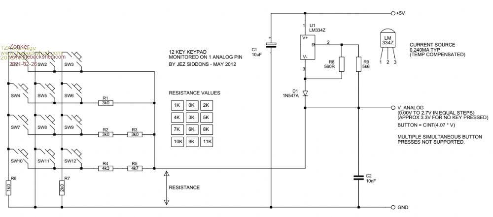

I remember seeing this from TZadvantage a while back... Nice circuit...

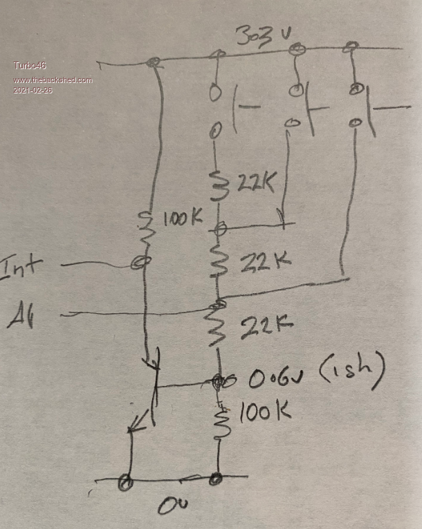

If you can use two pins then something like this could work. Please excuse the rough drawing.

@Mixtel90, Can you please explain your circuit a little more. If I am correct, you have a pullup resistor of 1K and the largest switched pulldown resistor is 470R.
That would give about 1 volt at the analogue input pin as you say but you need a digital input of less than 0.65 volts to give a digital zero to generate an interrupt. Or are you not using an interrupt?
A pullup resistor of 2K5 instead would give about 0.5 volts at the pin and should reliably generate an interrupt. The analogue resolution would be less but it should work OK. Around a count of 160 bits for 2K5 and 470R - 120 bits, 47 bits and 0 for the other values.
I like the idea!
