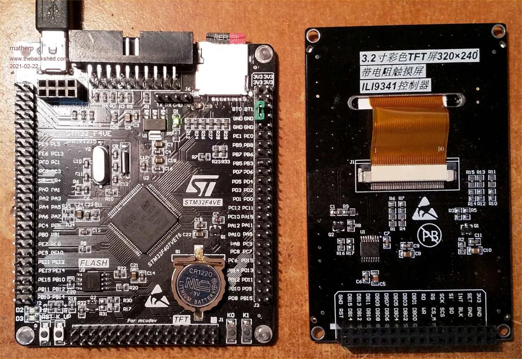

As I've mentioned previously the ArmmiteF4 is my favourite MMbasic port: faster than the MM+;, available as a very cheap ready-built board with battery backed RTC, SDcard, lots of I/O and even a flash chip; support for a wide range of LCD displays including a parallel connect ILI9341 that plugs directly onto the main PCB.
