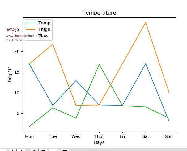

This is Python so not everyone will be able to but
Could anyone that knows Linux and Matplotlib help me out?
I need to learn how to import a data set from a csv file and display it in Matplotlib on the Pi
Ideally I need to learn how to make a graph that will read the data from the first row which is the header and has the colum names
Then use the data in the rows to make the plot
There are 3 to start with , temp hightemp and low temp
Eventually I'll be expanding this to use others and sub plots but I need to learn how to do this simple one first
I've learnt how to get readings of my weather station at set times during the day and save them to a csv file with headers
I've learnt how to make a Matplotlib with the data and make a graph that shows the data
This was just a simple one with some data points
What I want to learn is how to import data from the csv file attached* and use that data to plot the graph
data.zip
It has 4 columns Day, Temp, Temphigh, TempLow
and the rows have the data for various times throughout the day I want to graph
I know it won't look brilliant and  using a bar graph would be a better option but I couldn't figure out how to get that working with more than one data set
So  if anyone could help me by telling me how to use the data in the csv file to make the (bar)graph by reading the csv I'd be extremely grateful
I can figure out other stuff once I know how to read the data and use it in matplotlib
I did watch several videos and tutorials online but none actually helped as they weren't the same as what I want to do
