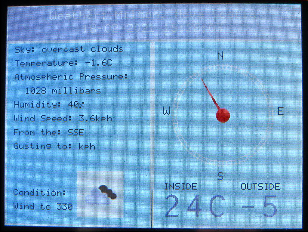

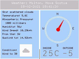

Inspired by lew247's rich pi-cromite weather station display (bottom of page 24) and Peter Mather's compass rose and ESP-01 wifi  efforts, I decided to make a version for the Armmite F4.
I signed up for an openweathermap.org account, downloaded the list of Cities, found the code for adjacent town of Liverpool, Nova Scotia, and after some fiddling on the PC was able to download the default data:
{"coord":{"lon":-64.7155,"lat":44.0335},"weather":[{"id":802,
"main":"Clouds","description":"scattered clouds","icon":"03d"}],
"base":"stations","main":{"temp":278.94,"feels_like":269.44,
"temp_min":278.71,"temp_max":279.15,"pressure":1008,"humidity":56},
"visibility":10000,"wind":{"speed":10.29,"deg":240,"gust":14.92},
"clouds":{"all":46},"dt":1612635812,"sys":{"type":1,"id":549,
"country":"CA","sunrise":1612611013,"sunset":1612647345},
"timezone":-14400,"id":6057856,"name":"Liverpool","cod":200}
From that I was able to work out how to extract the data. JSON$ is not available on the F4, so I wrote a very limited pseudo-json$ to pick out single values for single occurrences of a given key/name.
I hung a DS18B20 off of pin 1 for "inside temperature", and wanted to get the outside temperature from another device I have on my network. I figured out how the ESP-01 TCP GET was working for openweathermap, and set up my device to write the temperature within {} to a web server with a command like this on the openWrt device: echo '{-3}' > /www/oat.html
(If I had more than one value to provide from external sensors on my network, I'd put them out in pseudo-json$ format, e.g.: echo '{"oat":-3,"barnroom":18}' > /www/oat.html )
I read the DS18B20 with every program loop (there are no pauses except for processing for the ESP-01). If the temperature is dithering between one degree and another the display may change quite rapidly. I check the outside temperature once a minute. openweathermap.org says they won't allow you to retrieve your data more than once every 10 minutes, so I pick it up when minutes in time$ is at "00", "15", "30", "45". The seconds in the time display on the second line is updated every second except when the ESP-01 is working.
I pre-configured the ESP-01 to connect to my network on powerup (in AT mode, with the AT version 1.7 recently linked by matherp), so MMBasic code to do that is not included.
The standard 320x240 LCD is crisp, if small. Unfortunately, I can't get a good picture of it--tried both phone and camera.

  lizby said  The standard 320x240 LCD is crisp, if small. Unfortunately, I can't get a good picture of it--tried both phone and camera.
I find SAVE IMAGE File$ works well.
ChopperP
Posted: 10:47pm 18 Feb 2021
  Chopperp said  SAVE IMAGE File$ works well.
Perfect, thank you.
Edited 2021-02-19 08:57 by lizby
