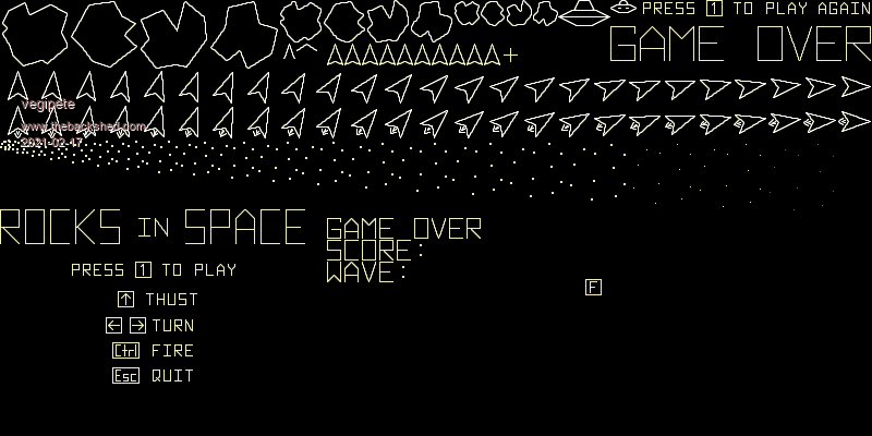

Here is the sprite sheet I created for the game "RocksinSpace":
Note there are various different sizes of shape, and while the shapes are
organized in patterns to some degree, there is no single rule to extract any
particular shape.

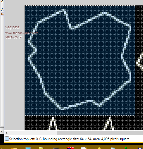

A bit of thought goes into placing the shapes as they are created. Using the
Rocks in Space sheet, we can see that the first large asteroid is located at
(0,0) with size 64x64. This pattern is repeated for the next 3, every 64 pixels
to the right. This allows the 4 large asteroids to be extracted mathematically,
starting from the base location of (0,0)

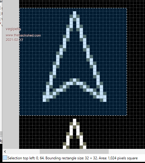

Knowing where the large asteroids are, the two rows of player ship can be added.
The base location is (0,64). Remember, the large rock is 64 pixels, from 0 to 63.
Each player ship is in a 32x32 pixel box. The use of a fixed pattern makes the
individual shapes easy to extract mathematically.
Similarly, all remaining shapes are added to the sprite sheet, and the locations
are noted. Usually I have the sheet open in the paint program as I am writing the
code that will use the shapes. That way, I can quickly put a selection box around
the shape of interest to ensure I know exactly where it is.
