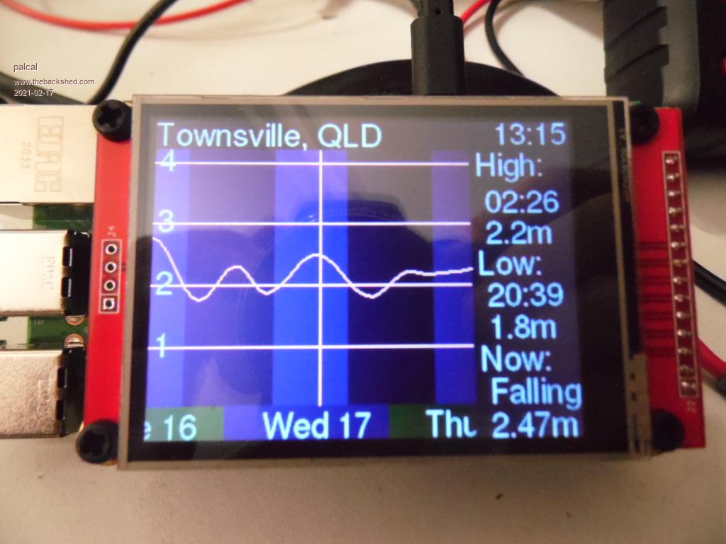

palcal
Joined: 12/10/2011
Posts: 2053
Posted: 12:40am 17 Feb 2021
Finally found out that Raspbian Stretch defaults to Python2 so I downloaded that.
I am finally getting somewhere the code runs and I have a UI on the screen.

palcal
Joined: 12/10/2011
Posts: 2053
Posted: 03:32am 17 Feb 2021
Well somehow I got it running, my only concern is that now it's headless the only way to turn it off is to cut the power, hope it doesn't corrupt the card.

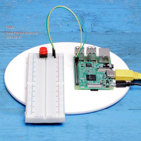

Posted: 09:13am 17 Feb 2021
It's really simple:
https://www.quartoknows.com/page/raspberry-pi-shutdown-button

palcal
Joined: 12/10/2011
Posts: 2053
Posted: 08:49pm 17 Feb 2021
Thanks for the ideas. I'll try the Button and see how it goes.
