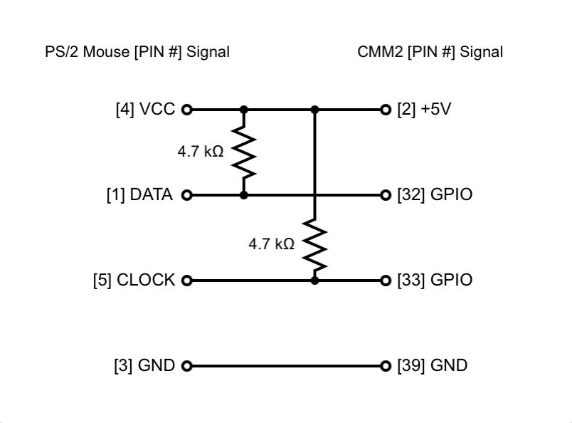

I can understand a circuit diagram, but I don't understand electronics enough to know how the sentence "both lines MUST be pulled up to 5V with 4k7 resistors" translates into a circuit diagram - please can anyone help me?
Also, there is a VCC pin on the PS2 connector, which I'm assuming should be connected to +ve power, but there are 2 different voltages on the I/O connector, 3.3V and 5V - I'm guessing I should be using the 5V - is that right?
Many thanks in advance
Posts: 12084
Posted: 02:06pm 15 Feb 2021
  Quote  I can understand a circuit diagram, but I don't understand electronics enough to know how the sentence "both lines MUST be pulled up to 5V with 4k7 resistors" translates into a circuit diagram - please can anyone help me?
Connect a 4K7 resistor between CLOCK and VCC and another between DATA and VCC
  Quote  I'm guessing I should be using the 5V - is that right?
Yes

@johngill, please have a look here
It should be obvious from the schematic  why they are called pull "up" resistors :)

These pinouts are unlikely to change, so for future reference (and possible inclusion in the CMM2 docs?), here 'tis the mouse circuit in bitmapped goodness. But, a "live" cloud-based repo of CMM2 circuits contributed by the community remains intriguing :)
Enjoy Every Sandwich / Joe P.
