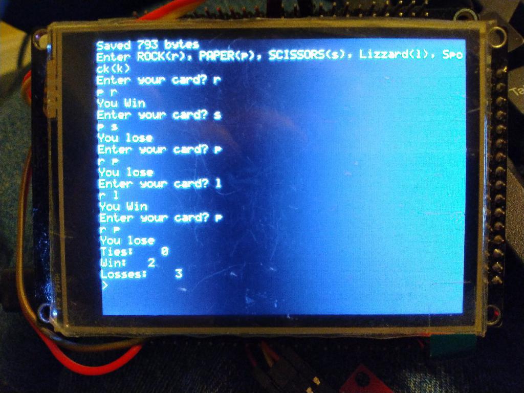

Posted: 03:29am 06 Feb 2021
With a PS/2 keyboard on an F4, 320x240 LCD, with OPTION LCDPANEL CONSOLE 7, here's the Rock, Paper, Scissors program:
(Note--the actual LCD is sharp, but my phone blurs it.)
The game playing

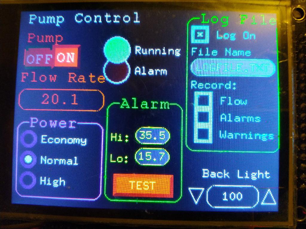

As an example of what's possible, here's Geoff's Gui Demo screen:
