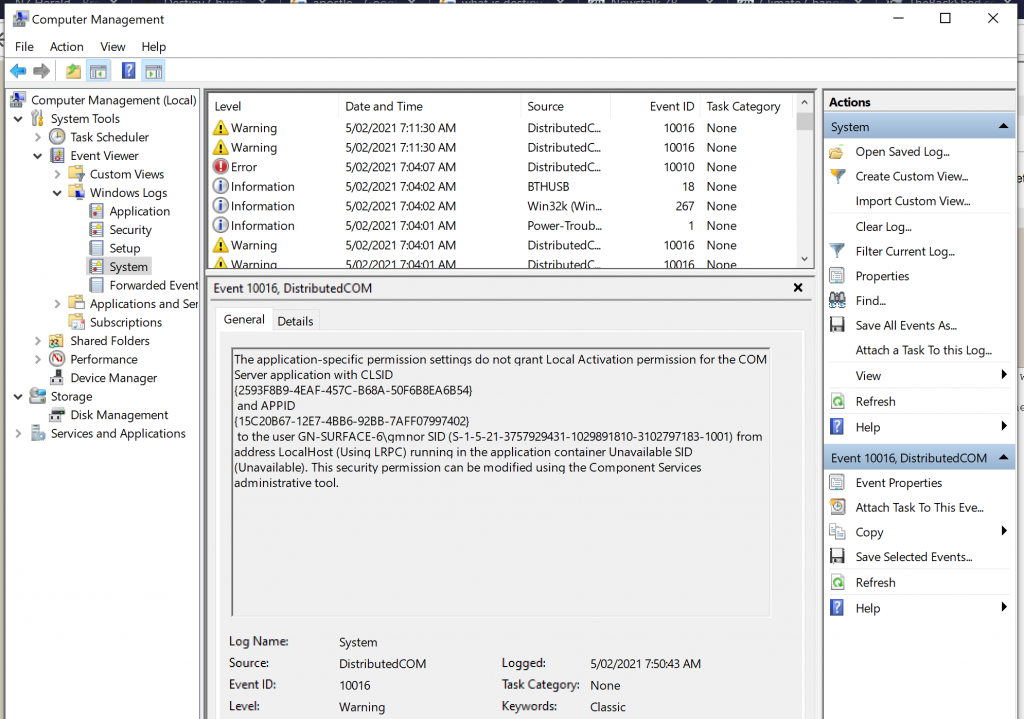

Have you tried looking at the "system" logs which are found in the "Event viewer" which is found in "Computer Management"
They take a while to be displayed under normal circumstances so with a slow machine it will probably take a while longer.
Start by looking for things flagged in red.
