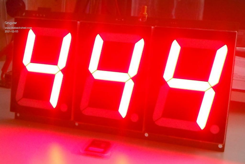

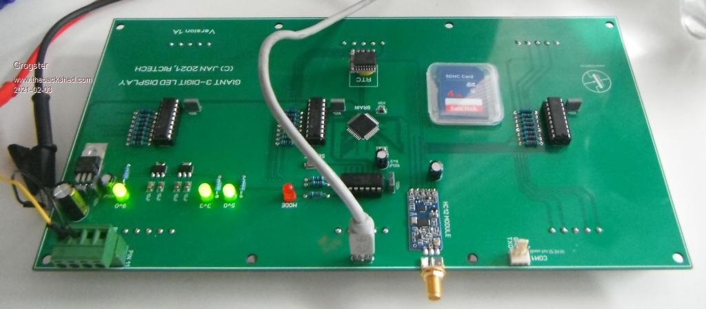

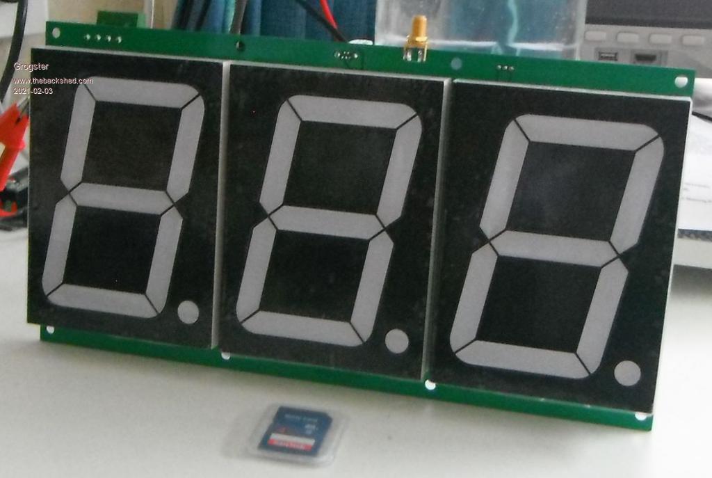

I needed a giant 7-segment LED display for my latest creation, and this is what I came up with:
The PCB size is 278mm x 145mm, and despite it's relatively large size, it is still very cheap to get made at JLC PCB - only US$5 per board.  Some PCB houses charge HUGE amounts once you go above their most popular sizes, such as 100x100.
The photos show the assembled module.  I plan to use two of these in hallways, one pointing each way down the hallway so that staff can easily see the numbers either side of the display.  My thanks specially to vegipete for making me aware of the Toshiba driver IC's I am using for each of the giant displays.
This is surprisingly cheap to build, and works a treat.  The giant 4" LED displays are only about US$2.50 each.
If anyone is interested in this, let me know, and I can compile a constructors pack with gerbers, sample MM2 code and BOM etc.

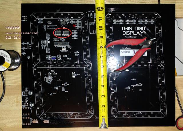

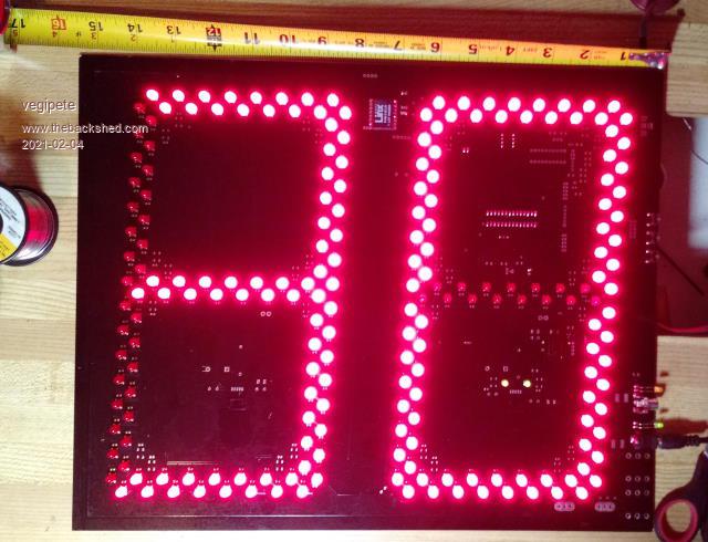

Here is the board I use the Toshiba TBD62783 on - two per board. Since the drivers are 8 channel and each digit is only 7 segments, 2 channels are left over. One drives a relay, the other drives a MOSFET used for optionally PWMing the low side for dimming. The PCB is about 12 1/2 by 15 1/5 inches. These are used as time clocks in sports arenas.
The nice thing about driving 7 segment LEDs this way is that you have individual control over each segment, so you can display anything you like.
