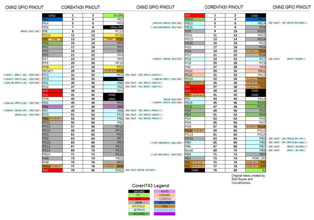

In the pinout below
Are the WHITE pins on the 2x80 pin headers available to use? if so how can I tell what they can be used for?
I get the colour scheme and the items on the 40 pin header etc, its the ones not listed

Posted: 08:58pm 01 Feb 2021
It's ok I think I get it
The pins in white are used for other items on the cmm2 board

  Quote  Are the WHITE pins on the 2x80 pin headers available to use? i
No: some may be used internally or are allocated and locked even if not actually used. You must limit yourself to the header pins + the Nunchuk pins + the IR pin + the temperature pin. If not you will almost certainly find they either don't work now or won't in the future. In any case they are not supported in the firmware so could only be accessed with a CSUB

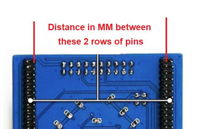

Does anyone know the distance between the 2 rows of pins on the Waveshare board?
I can find all sorts of infor on the board but no drawing showing the spacing between the headers

Posted: 07:34pm 02 Feb 2021
Inside rows 44.3 mm.  Outside rows 48.3 mm. Pin spacing 2mm.
