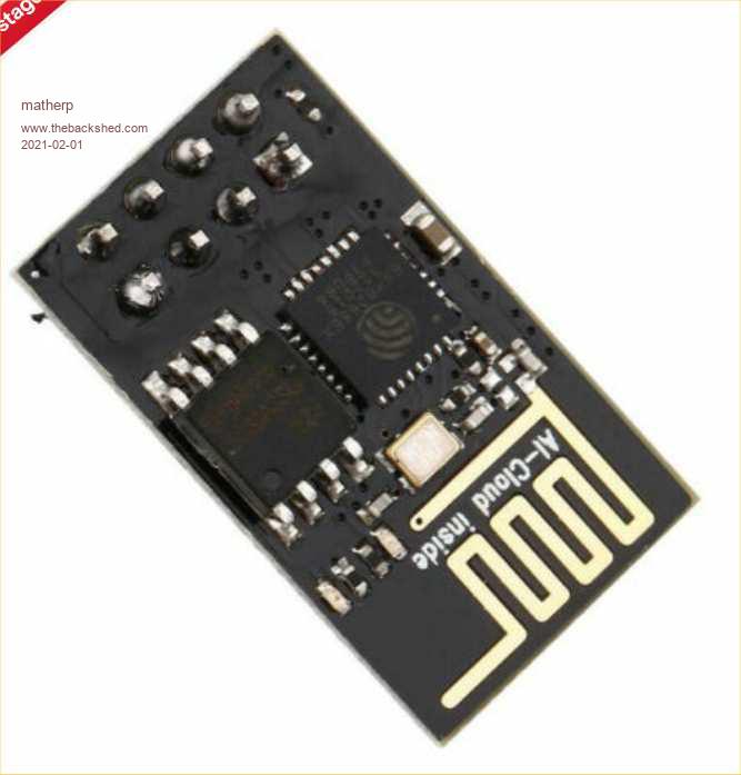

Newly bought ESP-01 are still being shipped with very out-of-date firmware.

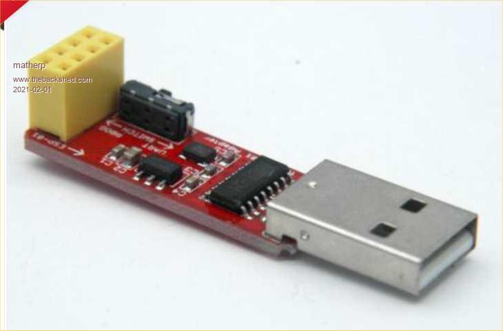

First buy one of these off ebay etc.
Make sure it is exactly this version with the switch

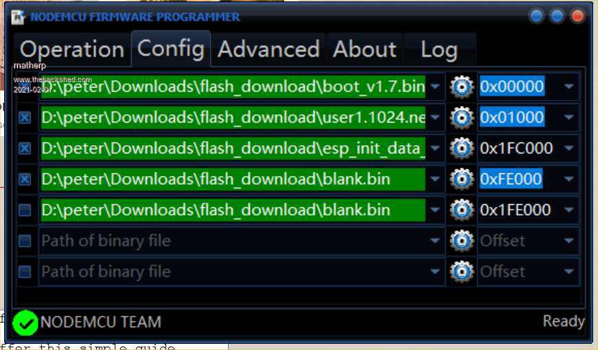

Plug the ESP into the adapter and set the switch to "Prog". Plug the adapter into a windows computer.
Run the ESP8266flasher program and set up the configuration as in the picture substituting the correct paths for your computer
Then go to the operation tab and press "flash". One minute later and the job will be done

I was not able to flash several black (4Mb) ESP-01s with my version of the red flasher module shown. I succeeded with a modified ESP-01 flasher as shown here.
With an unmodified version of that module I was able to connect to my wifi. This version, 1.7, is the first I've found for which the AT+CIPSNTPCFG=1,-4,"us.pool.ntp.org" command works. AT+CIPSNTPTIME? then gives you the time: +CIPSNTPTIME:Sat Feb 06 11:06:00 2021. I'm not sure how it knew the correct time zone--perhaps from the IP address. (EDIT: Oops, it knows the time zone by the "-4" in the CIPSNTPTIME command)
Wish I knew why my red flashing module didn't work--bad module?

Posted: 04:39pm 06 Feb 2021
  romba6 said  Did your flasher work with the switch set to UART on a terminal program? (115200 baud)
No. Didn't work either in PROG mode for flashing or in UART mode with an ESP-01 successfully flashed with the other module (that ESP-01 worked from my PC).

Posted: 09:48pm 06 Feb 2021
Using the flashing toll described by Peter looks easier than my homebrew flasher and the official flashing software. I often need several attempts to get the resetting right.
