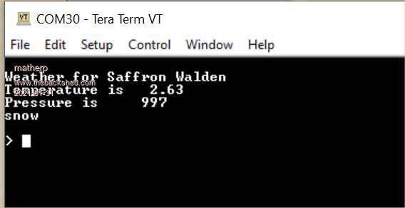

Print "Weather for "+json$(m%(),"name")
Print "Temperature is ",val(json$(m%(),"main.temp"))-273
Print "Pressure is ",json$(m%(),"main.pressure")
Print json$(m%(),"weather[0].description")

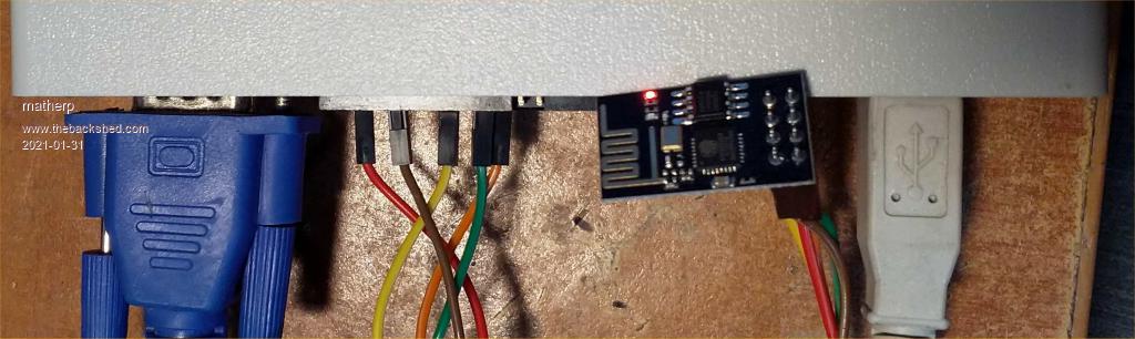

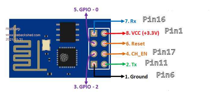

This is for running on a regular CMM2 - just connect a standard ESP-01 to com port 2 and power it from 3.3V/GND (make sure the CH-PD pin is also pulled high) and you have network access
Edited 2021-01-31 03:39 by matherp

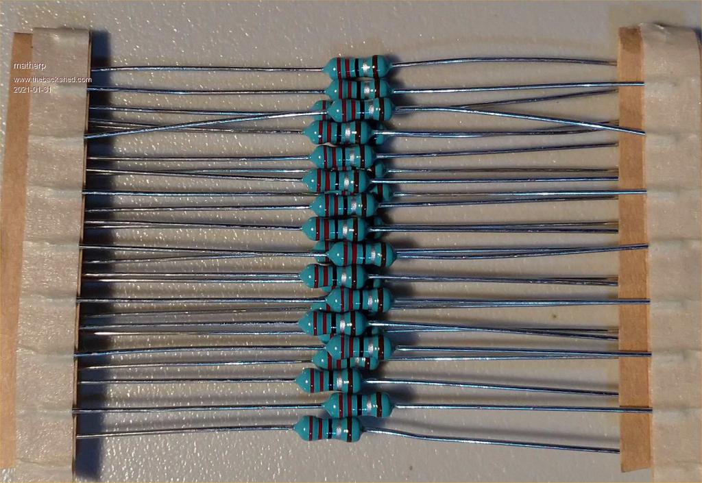

Didn't you say we shouldn't drive an ESP-01 from the CMM2's power rails a couple of months back because it can draw too much current under some loads?
Posted: 05:40pm 30 Jan 2021
Seems to test OK but put a 2.2R resistor in the 3.3V line and a 100uF cap across the ESP-01 if any problems
Edited 2021-01-31 03:43 by matherp
Posted: 05:46pm 30 Jan 2021
Did you really mean a 2.2 ohm resistor ... do they come that small, other than 0 ohm SMDs ?
Posted: 05:51pm 30 Jan 2021
Yes 2R2 as used already on the CMM2 in the power supply to the SDcard. Together with the cap just slows the spikes slightly
Edited 2021-01-31 03:54 by matherp

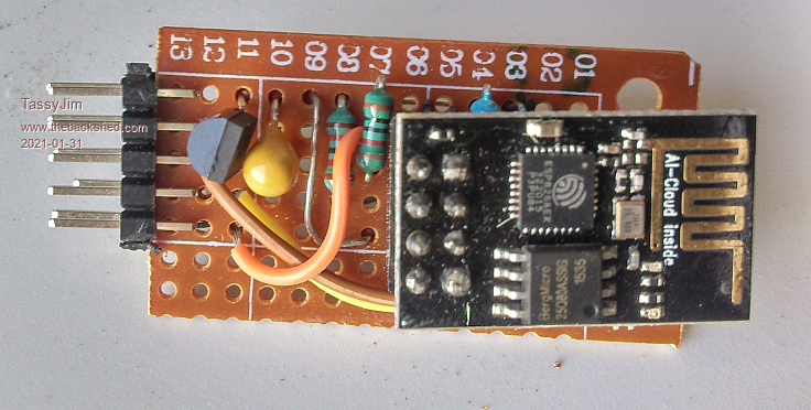

I used the 5V supply with a 3.3V regulator for my ESP interface.
I also used com1 so that all the pins are together on the expansion port.
Thank you for json, I wasn't looking forward to doing that in Basic.

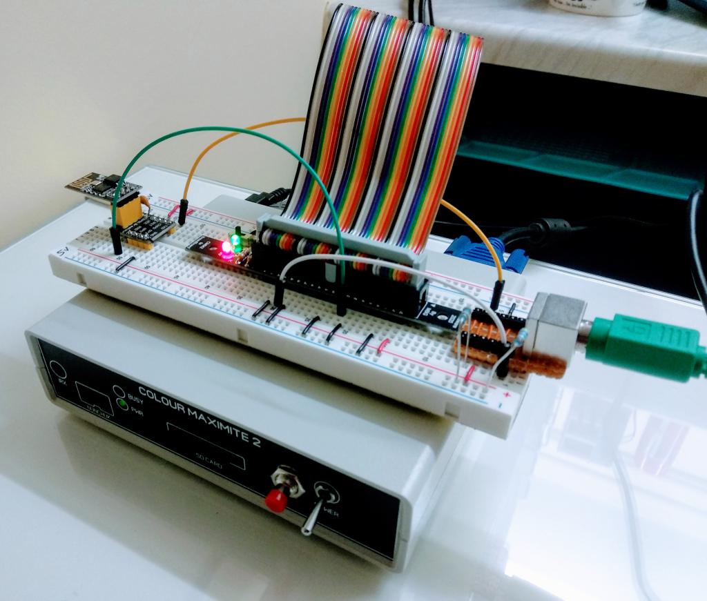

I've also found my ESP-01 module to not be terribly stable, sometimes it works, but othertimes it only flashes its LED on initial power-up and then will refuse to flash it further or make a connection. It will then stubbornly refuse for a while whilst I faff with the cables and switch things on and off a couple of times, or attach it to an external power supply and then it will decide it will work again after all even when connected back to the CMM2 3.3V power rail ??? Maybe that resistor and capacitor will help when the former arrives. TBH I'm not convinced that the 3.3V rail is always supplying 3.3V ... sometimes I'm measuring as low as 2.8V - though I must acknowledge there may be a certain amount of incompetence involved.
Anyway, if we get many more upgrades then I think I'm going to need a bigger breadboard:

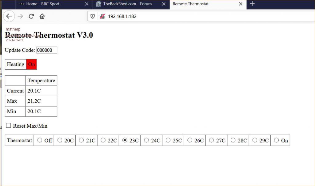

Posted: 03:51pm 31 Jan 2021
Here is a simple webserver using the ESP-01 in tcp server mode. Just substitute the login for your network in lines 8 and 9

     if mypage$= "INDEX" then
       drawpage
     elseif mypage$="D" then
       if nparams<>0 then 'we have parameters to process
         if arg$(0,0)="S" and arg$(1,0) = password$ then
           if arg$(0,1)="C" and arg$(1,1)="R" then 'reset the max min to current
             maxtemp=currenttemp
             mintemp=currenttemp
             var save setpoint,maxtemp,mintemp
           endif
           if arg$(0,1)="R" then 'change the setpoint and update the heater if applicable
             setpoint=asc(arg$(1,1))
             updateheater
           endif
         endif
       endif
       drawpage
     else
       SendText pnf$+crlf$+crlf$'invalid page
     endif
     EndSend 'clear the write buffer and terminate the write
   endif
 endif
LOOP
end
Function parsehtmldata$(paramcount as integer)
 local a$,b$
 local integer buf(Maxlen\8)
 local integer inpos,startparam,processargs
 paramcount=0
 inpos=lInstr(inbuf(),"GET /",1)
 if inpos=0 then
   parsehtmldata$=""
 else
   longstring mid buf(),inbuf(),inpos+5,1000
   inpos=lInstr(buf(),starttext$,1)
   If inpos>2 Then 'page request found
     inpos=inpos-2
     a$=lGetStr$(buf(),1,inPos)
     inpos=Instr(a$,"?")
     If inpos<>0 Then 'parameters found
       processargs=1
       parsehtmldata$=Left$(a$,inpos-1)
       a$=Mid$(a$,inpos+1)
         arg$(0,paramcount)=""
         arg$(1,paramcount)=""
         inpos=Instr(a$,"=")
         startparam=1
         arg$(0,paramcount)=Mid$(a$,startparam,inpos-startparam)
         startparam=inpos+1
         inpos=Instr(a$,"&")
         If inpos<>0 Then
           arg$(1,paramcount)=Mid$(a$,startparam,inpos-startparam)
           a$=Mid$(a$,inpos+1)
           paramcount=paramcount+1
         Else
           arg$(1,paramcount)=Mid$(a$,startparam)
           processargs=0
       Loop while processargs
     Else
       parsehtmldata$=a$
   Else ' no page requested
     parsehtmldata$="INDEX"
 endif
End Function
sub maxmin
 local integer update=off
 if currenttemp>maxtemp then
   maxtemp=currenttemp
   update=on
 endif
 if currenttemp<mintemp then
   mintemp=currenttemp
   update=on
 endif
 if update then var save setpoint,maxtemp,mintemp
end sub
sub updateheater
 local integer hcalc
 if setpoint=asc("L") then
   pin(relaypin)=ON
   heater=on
 endif
 if setpoint=asc("A") then
   pin(relaypin)=OFF
   heater=oFF
 endif
 if setpoint>=asc("B") and setpoint<=asc("K") then
   hcalc=(setpoint-asc("B")+starttemp)*10 'setpoint temperature * 10
   hcalc = hcalc + hysteresis
   if currenttemp>=hcalc then 'turn heating off
     pin(relaypin)=OFF
     heater=oFF
   endif
   hcalc = hcalc - hysteresis - hysteresis
   if currenttemp<=hcalc then 'turn heating on
     pin(relaypin)=ON
     heater=oN
   endif
 endif
end sub
sub drawpage
 local integer loopcounter,tempconvert
 local b$
 sendText header$
 sendText title$+form$+h2$+code$
 sendText tstart$+heat$
 if heater then
   sendText hon$+tend$
 else
   sendText hoff$+tend$
 endif
 sendText tstart$
 sendText h3$
 b$=s1$+outtemp$(currenttemp)+degree$
 b$=b$+s2$+outtemp$(maxtemp)+degree$
 b$=b$+s3$+outtemp$(mintemp)+degree$
 sendText b$
 sendText tend$
 sendText check$
 sendText tstart$
 sendText s4$
 for loopcounter=asc("A") to asc("L")
   if loopcounter=setpoint then
     sendText s5$+chr$(loopcounter)
   else
     sendText s6$+chr$(loopcounter)
   endif
   sendText click$
   tempconvert=loopcounter-asc("B")+starttemp
   if loopcounter>asc("A") and loopcounter<asc("L") then sendText str$(tempconvert,2)+degree$
   if loopcounter=asc("A") then sendText offstr$
   if loopcounter=asc("L") then sendText onstr$
 next loopcounter
 sendText tend$
 sendText ending$+crlf$+crlf$
end sub
