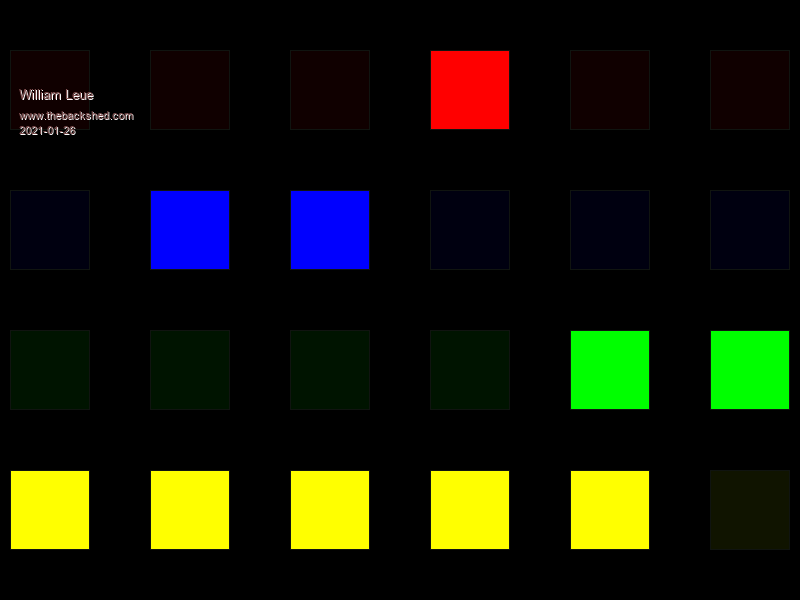

I seem to be into clocks today   Here is the second one, a very simple Binary-Coded Decimal (BCD) clock.
The picture shows the displayed time of 15:59:32 (24-hour time). Each column is a single digit of the time, hours for the leftmost 2 columns, minutes for the middle, and seconds for the rightmost 2.
Each column shows the binary equivalent of the decimal digit for that column, with the 1's bit at the bottom (yellow), 2's bit above it (green), 4's bit above that (blue) and the 8's bit at the top (red).
Using constants at the top, you can choose not to display seconds, and also switch between 12-hour and 24-hour time.
Enjoy!
